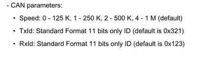

Eric60
Hi Alice,
OK thank you.  Is there a particular CAN message id or range that the boot loader responds to and sends to for the ISP frames and their responses?  This information is not in the reference manual either.
Eric
4,354 Views
Hello @Eric60
How about refer to:
Alice
4,333 Views
Eric60
Hi Alice,
Thanks for that information, it looks like what I need, however do you have a source document where you pulled this from?  I don't see it in the LPC5536 reference manual (Rev 3 July 2023).   I'm assuming the source document will explain how the speed parameters are used?
Eric
4,320 Views
Hello @Eric60
Sorry, the source in ROM is not public, and I also cannot access it. I found this information in the blhost documentation. A customer once configured it this way, and it worked. Therefore, I recommend it to you. You can download the doc from https://www.nxp.com.cn/docs/en/user-guide/MCUBLHOSTUG.pdf
