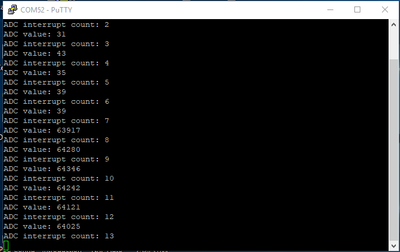

This is the result I run the lpadc_interrupt example in SDK package.
I have connected the ADC0_0(pin8 of J13 on LPC55S06-EVK ) to GND or 3.3V, this is the result.
If you want to use uart to display message as following, you have to close JP12.
In conclusion, no problem for the lpadc example in SDK package
