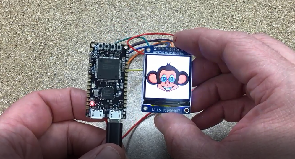

Unboxing video of the low cost OKDO E1 board.    As a quick demo, I hooked up the E1 to a low cost  240x240 Pixel IPS display from buydisplay.com.

At 7 minutes you mentioned needing 3.3 volts for your display. You should be able to hook up 3.3 volts on the X101 connector, pin 1. The schematic labels this VDD_TARGET. It's derived from N400 Torex XC6206P331MR-G and should be good for 200mA. LPC55S69 will take in the region 10mA and debug interface LPC11U35 takes about 12 mA.
Good information Mark.     I realized this after I had gotten everything recorded.       My brain was really looking for a +3.3v net label and I completely missed VDD_TARGET.    +3.3v is definately availabe on the pin headers for user acces.
