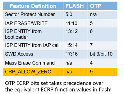

It looks easy but it is important to know that ECRP feature is controlled by both FLASH and OTP configuration! The most restrictive combination in both setting is needed
2.1          Where is FLASH ECRP:
ECRP is at 0x20 of vector table, it’s uint32_t type. We write to this address to set FLASH ECRP protection. The valid bits of FLASH_ECRP is 0-17bit, and the default value is 0xFFFF_FFFF. For detail, please see UM.
2.2          Where is OTP ECRP
OPT is a non-volatile and write-once register. OTP is not FLASH and it can be ONLY written by IAP function. OPT ECRP configuration is at OPT bank 3. The default OTP ECRP value is 0.
2.3          FLASH ECRP + OTP ECRP Decides the Protection.
See this table to show the combination.
Here OTP ECRP is always set with higher priority than FLASH ECRP!
