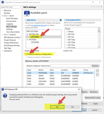

Right click “MCU” under Project tree, choose “Edit MCU”
Uncheck ”Preserve memory configuration”(it is checked by default)->choose LPC55S06->there is a warning, choose Yes.
We can see the Memory details changed to lpc55s06, then click ”Apply and close”.

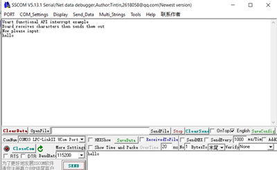

6 - Test the project  function with new board
Build project until no compile error, download and run it, result as below.
