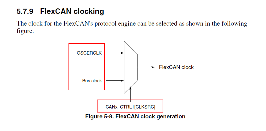

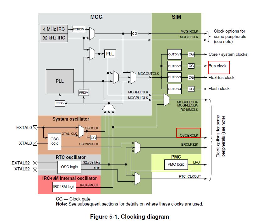

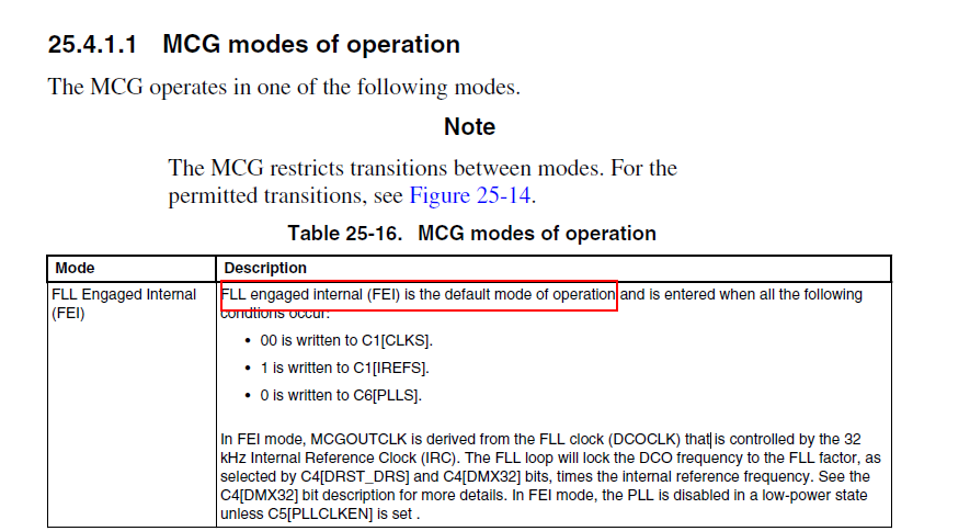

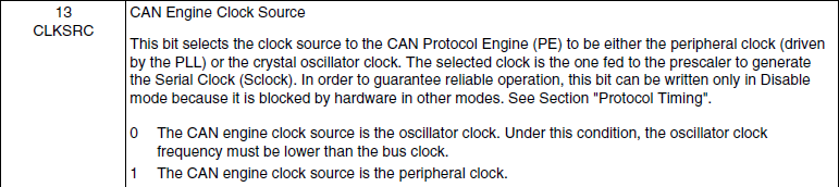

Hello Sean,
The default mcu clock mode is FEI, you can refer to here(from the K64 reference manual ) :
And the Flexcan clock , we can refer to here :
then , about the "OSCERCLK" and "Bus clock" , please see here :
