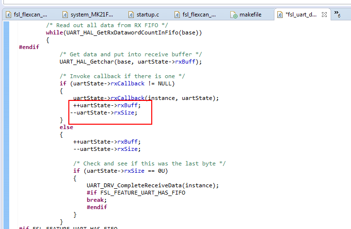

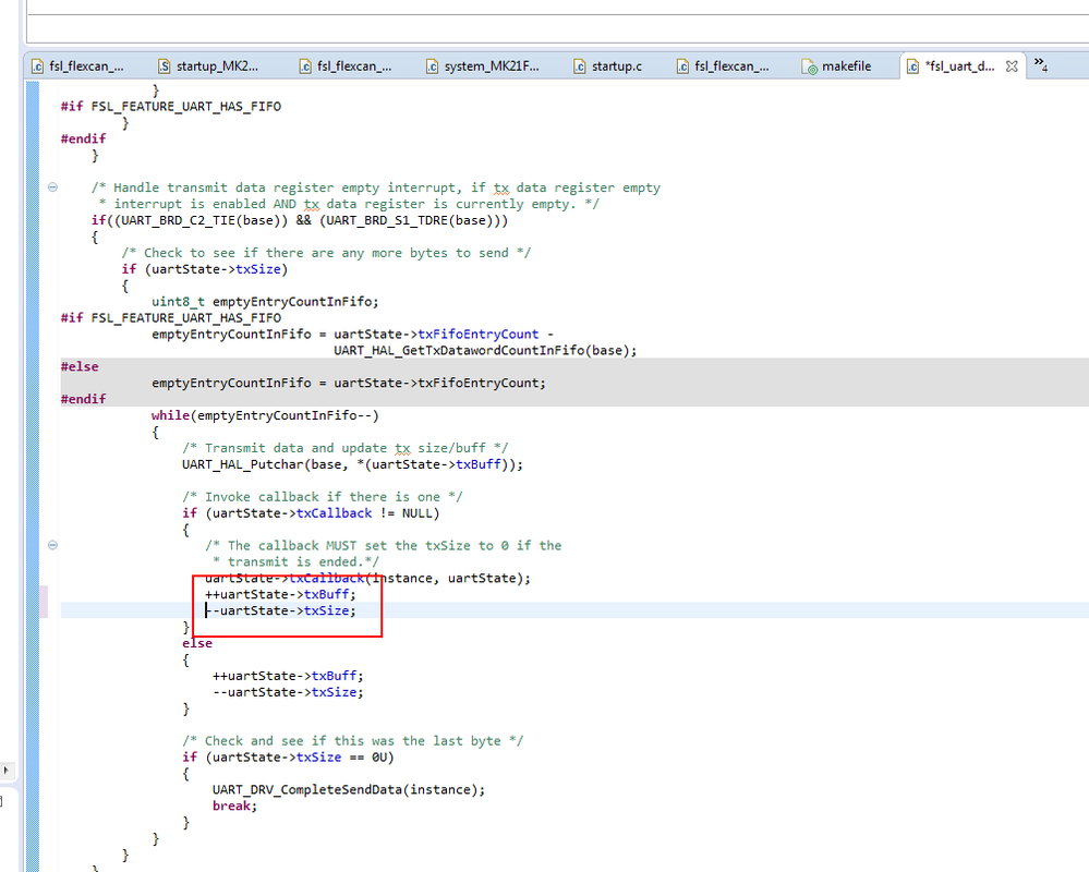

Hi Rande,
I think you enable the TX callback, if yes, there is a bug on the KSDK UART driver,
you need to fix it , and then re-build the KSDK lib , then build your project .
The fix method is
Add these code into the function of "void UART_DRV_IRQHandler(uint32_t instance)" in the file of "fsl_uart_driver.c"
++uartState->txBuff;
--uartState->txSize;
after add , it will like this :
also if you use receive function , also fix it :
Hope it can helps you
Alice
