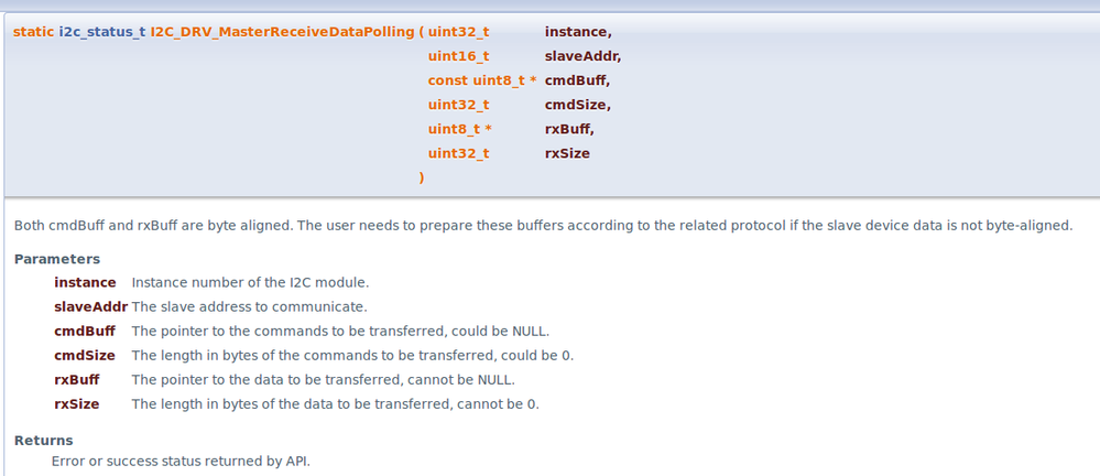

I use I2C_DRV_MasterReceiveDataPolling() that calls I2C_HAL_MasterReceiveDataPolling()
I find the docs:
in particular the third and fourth arguments.
I call
uint16_t addr;
uint8_t cmdBuff[2];
addr=0xf1ca;
cmdBuff[0] = (uint8_t)((addr>>8)&0xff);
cmdBuff[1] = (uint8_t)((addr>>0)&0xff);
I2C_DRV_MasterReceiveDataPolling(i2cEE_IDX, I2C_EEPROM_ADDRESS, cmdBuff, 2, pdata8, len);
Using a protocol analizer I can see that the first byte send by i2c (after the slave address), is correct, 0xf1. The second byte is not 0xca!

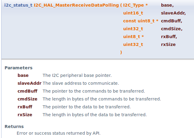

Debugging I follow the flow until I2C_HAL_MasterReceiveDataPolling() (lines from 440 in file fsl_i2c_hal.c):
   /* Send CMD buffer */
    if (cmdBuff != NULL)
        while (cmdSize--)
            if (!I2C_HAL_WriteByteBlocking(base, *cmdBuff--))
                /* Send STOP if no ACK received */
                I2C_HAL_SendStop(base);
                return kStatus_I2C_ReceivedNak;
The point is the line 445. There is *cmdBuff--, so the first byte tranferred is correct, but the second is out of the buffer (ideally at index -1).
I wonder if it is a bug, because the same decrement is also at line 554 (I2C_HAL_MasterSendDataPolling()).
If it is not a bug, I have to pass the pointer to the last element of a buffer (strange and counterintuitive), and the documentation should specify this behavoiur.
