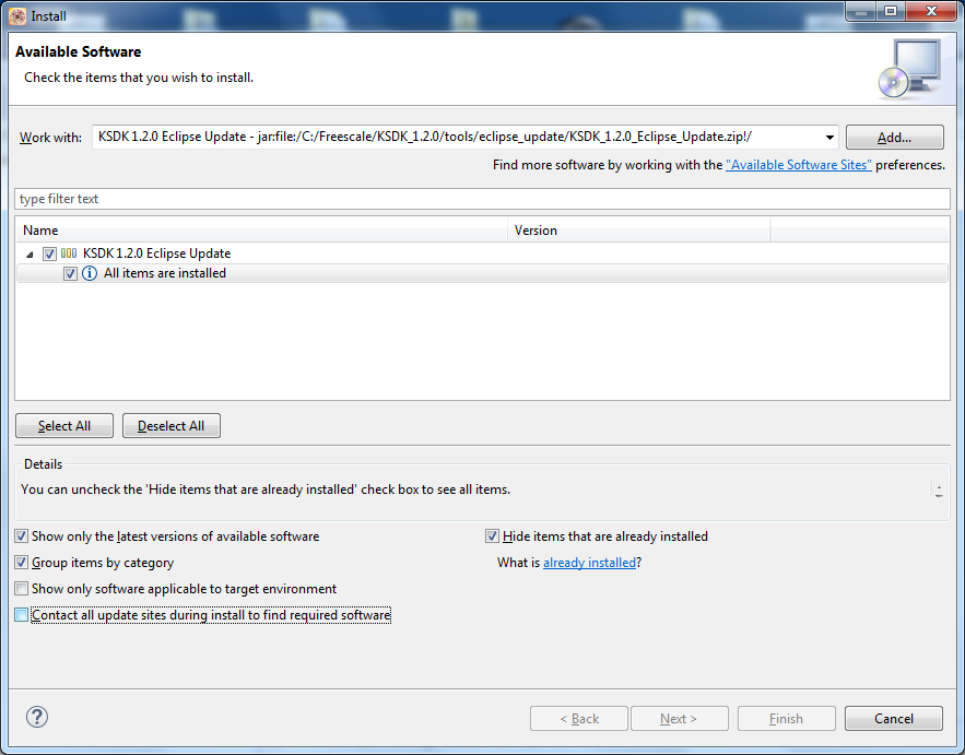

I installed KSDK 1.2.0, KDS 3.0.0, PE 10.4 and JLink V500, installed the KSDK a second time in KDS via help/install (because the
"installation program" is only a self-extracting archive) and then a third time the same way and now it can't be installed a fourth time because it is already installed:45298_45298.pngksdk1.2.0installed_2015-06-30.png
So now it is fully installed.

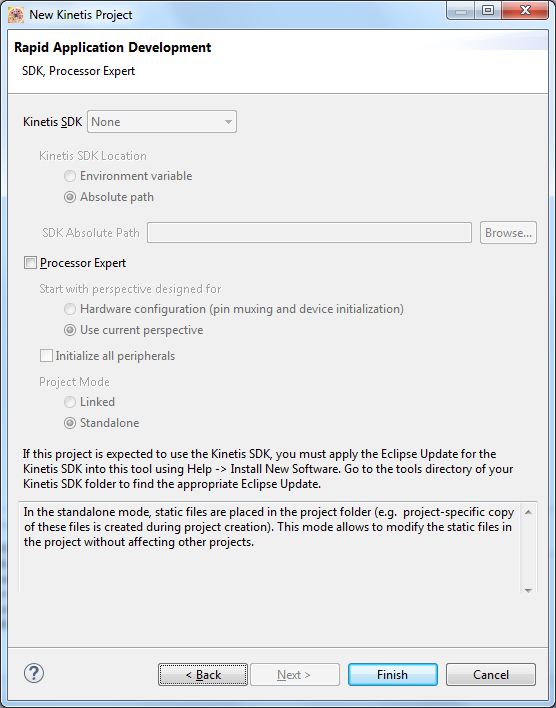

I also set the environment variable KSDK_PATH, but i still don't have a KSDK when i start a new Kinetis project for a processor (MK60DN256ZVLL10):
This results in strange errors like my code in the loop in main.c gets deleted and when i am using PE, and many components are shown but not availible, e. g. for gpio1:fsl_gpio i get the error "is not installed in this version of ProcessorExpert".
And without PE i can use no component, so i can use nothing; even LED blinking is not possible!
How can i start a new project with KSDK?

ivadorazinova
Hello Rolf,
yes - it is right, because MK60DN256ZVLL10 is actually no supported by current KSDK 1.2.
So what can I recommend you it use to supported devices. These devices you find at Release Note
I hope this helps you,
Iva

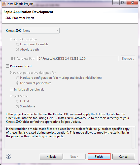

ivadorazinova
Hello Rolf,
sure, you can create new project in KDS without KSDK.
Just
or if you want to work with KSDK, you can follow the steps in the attached guide.
Iva

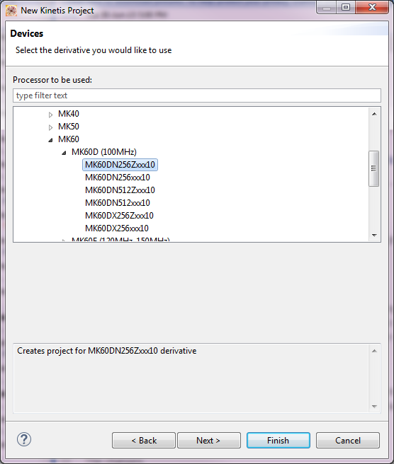

rolffreitag
I followed the instructions in the migration guide and found out that for MK60DN256ZVLL10 i have to choose MK60DN256VLL10 because they differ only in the DIE mask version.
But for all projects with this processor there is no support for PE and KDS, even in the example projects in the KSDK 1.2! So there is something still missing which is not mentioned in the guide.
Therefore i tried the other way, creating a project with the board twrk60d100 and switching the processor to type MK60DN256VLL10. This works; i can compile and debug with the Segger USB adapter and have the project with KDS and PE!

BlackNight
The SDK supported devices are listed in
C:\Freescale\KSDK_1.2.0\ksdk_manifest.xml
And there I see that the variant without the 'Z' is supported by the SDK, but not the one with the 'Z'
Erich
