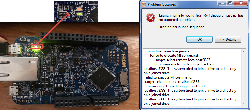

'Launching hello_world_frdm64f debug cmsidap' has encountered a problem.
4,685件の閲覧回数
alwilgus
I have a FRDM-K64F and have installed Kinetis SDK 1.3.0 Mainline - Windows.exe Kinetis Design Studio installer for Microsoft Windows 3.0.0.exe and mbedWinSerial_16466.exe.  The demo runs in Tera Term.  The 'Lib' and the 'Hello World' programs compile.  But when I load for debug I get, 'Launching hello_world_frdm64f debug cmsidap' has encountered a problem.  Please let me know how to continue.

Yes, but still have the same issues.  Anyone else having problems with the Hello World problem not working on a new install before/after the upgrade?

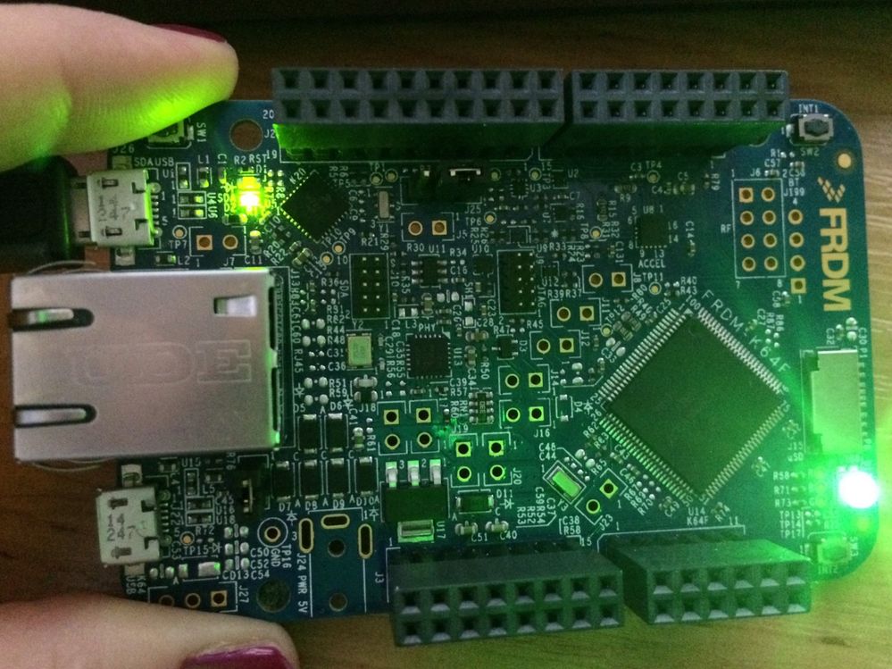

ivadorazinova
Hi Al,
if you face this issue
I tried with my FRDM-K64F
Also I´m attaching you the video.
I hope this helps.
Iva
