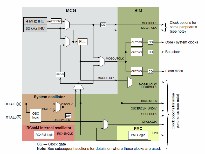

Our design is using an 16 Mhz external crystal for the K02.
I'm setting the clock manger for SystemCoreClock = 80000000 (80 MHz) with the following parameters:
const clock_manager_user_config_t g_defaultClockConfig =
    .mcgConfig =
        .mcg_mode           = kMcgModeFEE,
        .irclkEnable           = true,  // MCGIRCLK enable.
        .irclkEnableInStop  = false, // MCGIRCLK disable in STOP mode.
        .ircs               = kMcgIrcSlow, // Select IRC32k.
        .fcrdiv             = 0U,    // FCRDIV is 0.
        .frdiv   = 4U,
        .drs     = kMcgDcoRangeSelLow,  // Low frequency range
        .dmx32   = kMcgDmx32Default,    // DCO has a default range of 25%
        .oscsel  = kMcgOscselOsc,       // Select OSC
#if FSL_FEATURE_MCG_HAS_PLL1  /* There are NO PLL on K02 */
        .pll0EnableInFllMode        = false,  // PLL0 disable
        .pll0EnableInStop           = false,  // PLL0 disalbe in STOP mode
        .prdiv0                     = 0x1U,
        .vdiv0                      = 0x6U,
#endif
    .simConfig =
     .pllFllSel = kClockPllFllSelFll,
     .er32kSrc  = kClockEr32kSrcOsc0,
        .outdiv1   = 0U,
        .outdiv2   = 1U,
        .outdiv3   = 3U,
        .outdiv4   = 4U,
    .oscerConfig =
        .enable       = true,  // OSCERCLK enable.
        .enableInStop = false, // OSCERCLK disable in STOP mode.
        .erclkDiv     = 0U,    // OSCERCLK divider setting.
Our UART driver module is not reading the proper characters from our device.  This configuration is from the K02 Reference Manual.

Muxing the flash clock out to PTC3 gave us the following results with:
.mcgConfig.drs     = kMcgDcoRangeSelMidHigh, // 12Mhz = 60 Mhz SystemCoreClock
.mcgConfig.drs     = kMcgDcoRangeSelHigh, // 16Mhz  = 80 Mhz SystemCoreClock.
We went with kMcgDcoRangeSelHigh to get us the 80 Mhz frequency.  We continued with out testing on the UART and the data received match what was expected.

xiangjunrong
Hi, An,
At the time being, I think you have to know the exact clock frequency of the core/system clock. There is a pin
PTC3/CMP1_IN1/SPI0_PCS1/UART1_RX/FTM0_CH2/CLKOUT
you can use the code and hook the scope to PTC3 to test the flash clock.
//enable PORTC clock
SIM_SCGC5|=0x800;
PORTC_PCR3&=~(0x700);
PORTC_PCR3|=5<<8;
SIM_SOPT2|=2<<5; //CLKOUT output flash clock
//checking the SIM_CLKDIV1 register  setting, you can figure out out the core/system clock, the core/system clock drive the UART module for K0
Hope it can help you.
