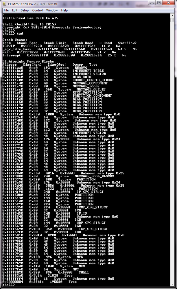

The one way how to set TAD shell is to use current example shell for e.g. FRDM-K64F, modified it and use it.

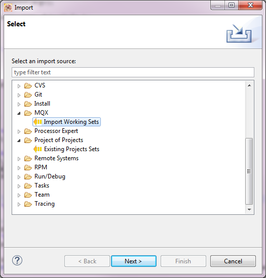

1. Open demo Shell (located at C:\Freescale\KSDK_1.2.0\middleware\tcpip\rtcs\examples\shell\build\kds\shell_frdmk64f) in KDS, as .wsd file
2. Open demo_cmd.c (located at /shell_frdmk64f/Source/demo_cmd.c) and add the line for shell tad,
{ "echosrv",   Shell_echosrv},
    { "echo",      Shell_echo},
    { "email",     Shell_smtp },
    { "gate",      Shell_gate },
    { "gethbn",    Shell_get_host_by_name },
    { "getname",   Shell_getname },
    { "getrt",     Shell_getroute },
    { "ipconfig",  Shell_ipconfig },
    { "llmnr",  Shell_llmnrsrv },
{ "tad",  Shell_tad },
3. Open tad.c (located at /mqx_frdmk64f/MQX_Generic/tad/tad.c) and remove at the first line:
      #if MQX_USE_IO_OLD
and last line
       #endif // MQX_USE_IO_OLD
and included fio library
      #include <fio.h>
4. Build libraries first, then build demo shell_frdmk64
5. Set the Tera Term and after typing tad in Tera Term, you will see the output:
Enjoy!
