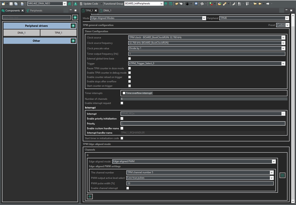

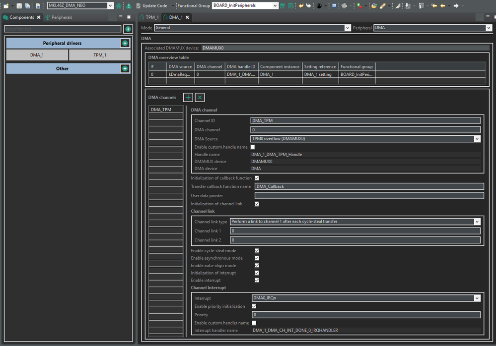

Hi everybody.
I'm using the FRDM-KL46z with MCUXpresso and I want to control a NEO-Pixel LED but I need to use the TPM and DMA.
I configure the DMA with config-tools as follow.
pastedImage_1.png  And the TPM is the same and as follow.

But the overflow in TPM don't generate the request DMA to send the data to cnV counter of TPM only if I just not comment the Line 60 "DMA_StartTransfer" the counter register refresh it but this only execution it a once and I want to refresh the Counter register channel every time that an overflow occurs.

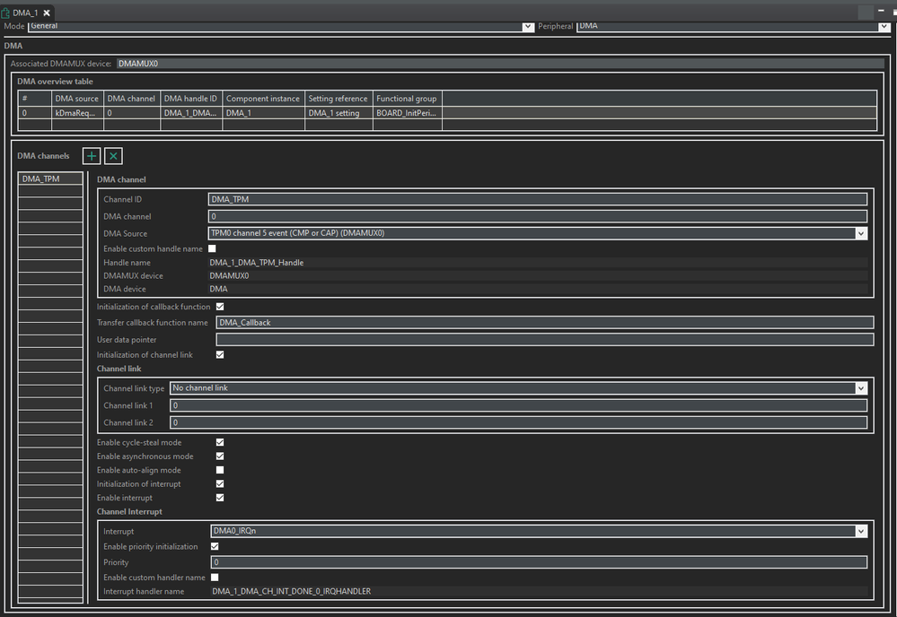

Hello nxf54944 thanks for your answer, I solved this problem some days ago, but now I don't use the overflow DMA request, I only use the the TPM channel request and my code is this.

And I disabled this parameter on DMA config.
I could tell that a MCUXpresso's function disabled my configuration on the DMA Control Register, and the fuction is...
status_t DMA_SubmitTransfer(dma_handle_t *handle, const dma_transfer_config_t *config, uint32_t options)
    assert(handle != NULL);
    assert(config != NULL);
    /* Check if DMA is busy */
    if (handle->base->DMA[handle->channel].DSR_BCR & DMA_DSR_BCR_BSY_MASK)
        return kStatus_DMA_Busy;
    DMA_ResetChannel(handle->base, handle->channel);     //This clean the Control Register and any configuration!!
    DMA_SetTransferConfig(handle->base, handle->channel, config);
    if (options & kDMA_EnableInterrupt)
        DMA_EnableInterrupts(handle->base, handle->channel);
    return kStatus_Success;
And I changed this function for this other.
void DMA_SetTransferConfig(DMA_Type *base, uint32_t channel, const dma_transfer_config_t *config)
    assert(channel < FSL_FEATURE_DMA_MODULE_CHANNEL);
    uint32_t tmpreg;
    /* Set source address */
    base->DMA[channel].SAR = config->srcAddr;
    /* Set destination address */
    base->DMA[channel].DAR = config->destAddr;
    /* Set transfer bytes */
    base->DMA[channel].DSR_BCR = DMA_DSR_BCR_BCR(config->transferSize);
    /* Set DMA Control Register */
    tmpreg = base->DMA[channel].DCR;
    tmpreg &= ~(DMA_DCR_DSIZE_MASK | DMA_DCR_DINC_MASK | DMA_DCR_SSIZE_MASK | DMA_DCR_SINC_MASK);
    tmpreg |= (DMA_DCR_DSIZE(config->destSize) | DMA_DCR_DINC(config->enableDestIncrement) |
               DMA_DCR_SSIZE(config->srcSize) | DMA_DCR_SINC(config->enableSrcIncrement));
    base->DMA[channel].DCR = tmpreg;
And now I achieved make I wanted, I hope that this help someone

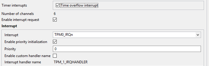

Omar_Anguiano
Hello Abraham Rosas
Checking your configuration I noted that the TPM interruption is not set. Please try checking these boxes.
If the interruption is not set then the DMA will not know if the TPM has overflowed.
Let me know if this helps.
