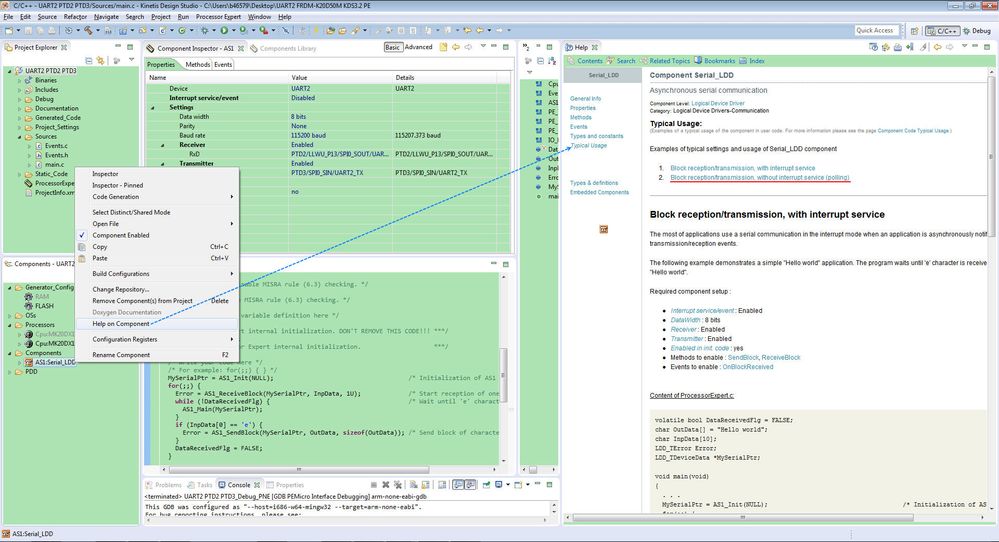

Refer the Typical Usage of Component Serial_LDD.

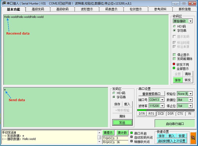

After input 'e' at UART2_RX(PTD2 Pin8 J2), I can receive the 'Hello world' from UART2_TX(PTD3 Pin10 J2).
I have attached the test project.
