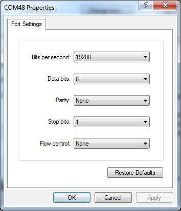

I'm trying to figure out why I don't see the output from my FRDM-KL46Z dev board in Teraterm.
Installed the latest serial driver and updated the firmware of my dev board to latest as well. Successfully uploaded a few demo programs to my dev board - they work as expected. Under the Portable Devices in Device Manager I can see MBED listed. I use correct settings for Com communication but when I connect the screen is blank with no activity.

I had tried the below MBED image and could get the serial terminal print info:
Below is my Win7 info:
If customer still meet problem with MBED OpenSDA image, I would recommend customer try with Segger J-Link image for OpenSDA. Customer could download related image from here.

Ok, I figured what went wrong. I uninstalled nxp's mbed driver from devices and hardware under USB and re-installed it. It started to work and now I'm able to see mbed Serial Port in TeraTerm! Your screenshot gave me a hint, so thank you!

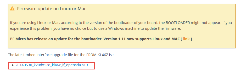

unfortunately, I already tried this approach and it's not the latest firmware.
Here Firmware FRDM KL46Z - Handbook | mbed  you can find the latest driver and a firmware. I don't see a way of how this can be fixed, there must be an issue with a firmware but if you have Win7 then you can try installing driver and firmware and let me know if you had any luck with Teraterm of similar.
