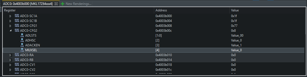

I am sampling data on channels ADC0_SE4A and ADC0_SE0 and I am able to sample on the channels independently everything works great, but when I sample one channel and then another the second channel always returns incorrect values, usually 65XXX or something like 4.  I thought that I had read somewhere that this is caused by an issue with switching between channels, so the fix was to sample only the same channel type.  I want to make sure this is the case before I do a board respin.  The microcontroller I am using is:     MKL17Z64VDA4

Thank you for the help.  Is this related to muxing the ADCs at all?  I know you have to select A or B, but I am unsure on an unlabeled one.
Thanks again!
6,793 Views
diego_charles
Hello Evan,
The muxing of ADC channels have to be done by the user,  so maybe you are facing a problem with your channel muxing technique, without taking a look at it to me is difficult to tell where the error is.
Your statement on channels of set A and B is correct, there is a bit called MUXSEL from  ADCx_CFG2 register. that allows selecting between alternate sets of ADC channels.

So I think I have the muxing set, and I am still seeing the issue.  I am sure I am missing something, I am jsut not sure what.
Thanks for all the help, and please see below.
The documentation says that setting it to 0 selects A:
And when I look at the MuxSel register value I see that it is 0.
My ADC init code is as follows:
