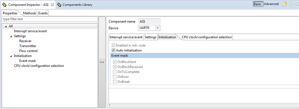

I cannot seem to get the Serial_LDD module to receive any characters.
What bothers me is that I've set a breakpoint in the Event.c onBlockReceive interrupt, but the program NEVER reaches it. I have tried arduino console, putty, python for sending serial characters, checked the serial port a hundred times, doesn't seem related to the computer.

If somebody can hint me why it's not working, I would appreciate it because I'm completely stuck. I'm just stunned that this simple code won't simply work. I'm using KDS 3.00 and KL26Z

I receive strictly nothing. Also checked speed (9600 bauds), same on both sides. This is starting to be very frustrating

Is initialization done by PE_low_level_init() or by separate AS1_Init() ?
Do you enable receiver and transmitter in Processor expert?

it is done in PE_low_level_init
Is there anything else to activate transmitter and emitter ?

I forgot to check transmitter and emitter pins, for using KL26Z usb serial I think they were wrong by default.
I think the following pins are right :
Receiver : TSI0_CH2/PTA1/UART0_RX/TPM2_CH0
Transmitter : TSI0_CH3/PTA2/UART0_TX/TPM2_CH1
I'll edit once I tested that

OK now I can send characters appropriately. I also solved my initial issue, the mcu never seemed to receive the incoming characters because I am using the MULT2B sensor shield that hosts a bluetooth module. This module will capture any incoming data on the openSDA port, that will not be forwarded to the MCU. And thus the MCU will never see this data if connected by USB cable. Once I removed the shield, the MCU behaved as expected.
