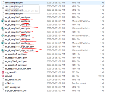

For generating new signed image, I have used Over the air Programming application, I'm using old root certificates files (generated by using SPSDK python files, OEM keys and certificate, for your reference please refer to attached image) which we have generated to burn the fuses at the time of flashing BLE firmware provided by NXP.

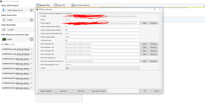

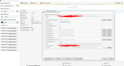

  5. I have used JSON file configurator as described in below image
  7. Replaced our keys in Keys_and_certs folder
  8. I have used below configuration for JSON for creating sb3 container

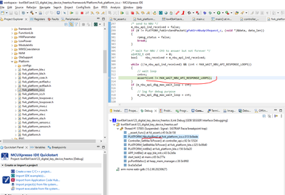

Hi, I'm facing one more issue, I have sdk SDK_2_12_7_KW45B41Z82xxxA and we found out new ble controller binary kw45b41_nbu_ble_1_9_12_3.xip file, I have generated the sb3 file out of it because I'm using our own pcb and keys and certs, I can successfully flash generated sb3 via blhost utility, but when I flash application code through MCuxpresso debugger, application code is going to fault state, please refer the below image
and when I revert to old sb3 file(this was also generated a year ago using this kw45b41_nbu_ble_1_9_10_0.xip verison), this fault is not coming, code runs fine.

Ricardo_Zamora
It is necessary to work with the matching NBU image for the SDK version of the application you are working with. This means that when you download your SDK, prior to loading any wireless SDK example, update your NBU image with the provided binaries in the following folder of the SDK.
If you are using a custom board, with your own keys, you also need to march the NBU version and the SDK application you took as a base.
Ricardo
5,242 Views
chris123951
Thank you, after updating NBU image and new sdk framework and driver, OTAP works fine now.
