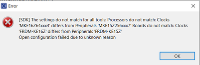

Hi! I am trying to start a project with FRDM 16KEZ. I included in MCUXPRESSOR the sdk for the board and crated a new project using it. When i want to use Pins or Peripherals when i select the project nothing happens and a error says that the MCU is not selected. I tried to right click on the project and use MCUXPRESSOR config tools but i get this error.
This error seems strange to me because i nevers used FRDM 15KEZ and i dont have the sdk for it.

That's because you are using the FRDMKE15Z to make the FRDMKE16Z project, download the SDK for the specific MCU

I am using the sdk for FRDMKE 16Z. This is why i made this post because it s very strange bc i never integrated something related to 15Z.

I just programmed the card with the example of the blinky led, and it gave me no problems, could you please tell me the steps you followed to get to this problem? and what version of MCUXpresso are you using?

I fixed it. When i downloaded the sdk from the IDE it didn t work, but when i downloaded the sdk from the NXP site and included the zip in IDE, it worked. Thanks!
