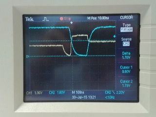

jackylau
Hello Xiangjun,
Thank you for the suggestions. Here are the checks that I've made:
Any address with bit 13 high result in reading 0xAD, that includes from 0x2000 to 0x2FFF. (thus any location in X2XXX to X3XXX, X6XXX to X7XXX, XAXXX to XBXXX, XEXXX to XFXXX). Any other address are working correctly.
Using a scope, I've found the following.
1. FB_A13 (via A67) is behaving correctly.
2. Writing to Address location 0x2000 is behaving correctly - I've scoped the CS (via B64) with each of the data pin (via B80 to B73). All logic's working correctly.
3. Reading Address location 0x2000 is bad - the behavior of the address pin's fine - Address pin shows the value 0x2000. Data pin is showing strange values: The pin's driving to some "in-between" values:
B73 (D7): 2.36V (H)
B74 (D6): 0.96V (L)
B75 (D5): 1.76V (H)
B76 (D4): 0.96V (L)
B77 (D3): 2.36V (H)
B78 (D2): 1.76V (H)
B79 (D1): 0.96V (L)
B80 (D0): 2.36V (H)
The value agrees with what the flexbus read: 0xAD, so flexbus sampling is correct, but the signal driven on the flexbus by the MRAM is not right.
I've attached the main program I use to obtain these values, and the scope image of the signal line.
Above is the signal I saw - blue being the CS, yellow is B80 (D0).
