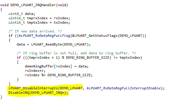

Hello Cyril,
My name is Sabina and I'll be happy to assist you. Could you please share where in your code you are disabling your UART IRQ?
I have reproduce it from my side, but it successfully disables the interrupt handler. For example, I put the same functions you are using at the end of the handler so I will enter only once at the beginning.
After receiving one character successfully, it never returns to the handler.
Please let me know your results from your end, by applying the same on the lpuart_interrupt example from the SDK.

Thank you for reaching out. The code has changed tremendously since then, and I think I found the reason why the interrupt couldn’t be disabled.
I was trying to disable it while executing the IRQ handler. I think I should have gotten out of it and then disable.
Let me know if that makes sense for you as well.
