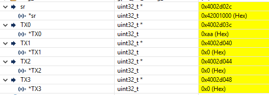

after using DSPI_SlaveTransferNonBlocking(SPI1, &g_s_handle, &slaveXfer), the registers state is correct :
SR & TX0 are as expected.

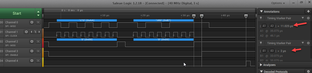

Please see the image attached. I am sending a byte at the same time that the Master is sending the first data.
I tested by my side, working on the driver_examples_dspi_interrupt_b2b_transfer_slave from the SDK.
I am sending just one byte as you.
Yes. It is on purpose. I want to chain 2 transfers into the same "CS Low" if I can say.
You are trying, in this case, to send 0xAA and 0xBB, aren't you?
I am following your implementation and using the SPI included in the SDK.
I commented on the Stop Transfer and Flush Fifo, the DSPI_SlaveTransferNonBlocking is implementing these 2 functions.

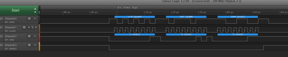

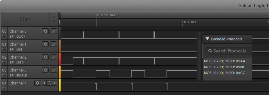

Sorry I should have started by some screens.
Here is my problem rephrased:
I don't get the CS influence when I'm chaining 3 transfers of a given size (1 in this case). With the same code on the slave side (cf. the file provided with the first post), I get two different results, whether or not I raised the CS between the transfer.
With CS lowered and raised between transfer:
Without CS lowered and raised between transfer :
PTC17 is raised for timing purpose, It helps me to see when I'm in the interruption after the transfer (Channel 4 on the screens).
As you can see when the transfer is finished, the interruption is triggered with and without the CS. In one case (without CS) I got 0xAA then 0xBB the 0xCC and in the other, a "delay" is created.
I hope it will help you understand my issue.

Hi Loic,
Please see the image below, the CS is going up after the end of the transmission. I am using 2 KW36 boards.
This time delay is creating by your master application. I am not sure why the CS is taking a lot of time to returns to the high value. Please see the next image.
The timing marker pair is showing the time form the last falling edge of the CLK to the rising of the CS. The time is 2us, after that, the KW36 takes 11us to toggle the PIN(following the same process that you did.)
The KW36 is waiting for the CS rising edge, but as the Master application is taking some time, the slave enters in another process. If you look at each to toggle pin, the "delay" is increasing, this is because the CS takes more time to change the status
