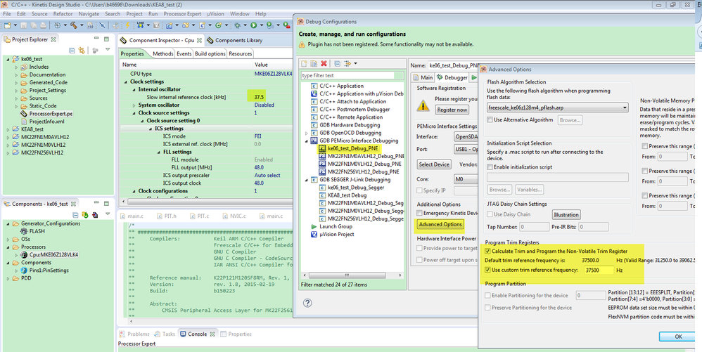

I've got a peculiar problem.  We are using a KE06Z128VLH4 and KDS 3.0.0.  The KE06 is using the FEI clock at 48 MHz and we are using a P&E Multilink Universal FX.  For some reason, during debug in one environment the ICS_C3 register which trims the internal clock is being reset to 0x80.  The default values are typically 0x4f-0x5b for the factory trim value.  What is strange is that using the same debug configuration settings and the same board, one computer is debugging normally with the ICS using the factory default trim, but on another the trim is being reset to 0x80, which is throwing the clock off.  We can't find any option under the debug settings to control this, and we are using the same ARP file.  We even tried deleting the debug configuration and creating a new one.  The board boots normally out of ROM and runs at the correct speed, it's just under debug on one machine the ICS is somehow being changed.  Is there some option that we are not finding?  I see the ARP file sets the ICS trim value, but is there someplace else the debugger changes it?  I've confirmed that the 0x3FE and 0x3FF locations contain 0x4F and 0x00 respectively for the board.

     This is just the middle trim address, it only can be used when you use the P&E debug tool, and enable the trim function both in the PE configuration and the P&E debug configuration.
About the configuration, I already have shared the picture with you before,check floor 2.

  This picture is the result which I enable both the trim function in PE configuration and the P&E debug configuration.

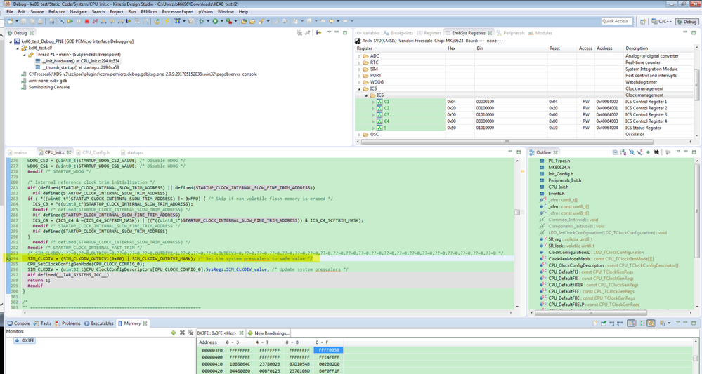

  You can find the 0X3FE and 0X3FF already have the trim data.
  The above picture, which I did copy the data from the 0X3FE, an 0x3ff, you can find actually, because the default factory trim value is 37.5Khz, so even I enable the re-trim function with P&E tool, the trimmed data is the same as the default factory data.
   This picture is after read the data from address 0x3fe, 0x3ff.

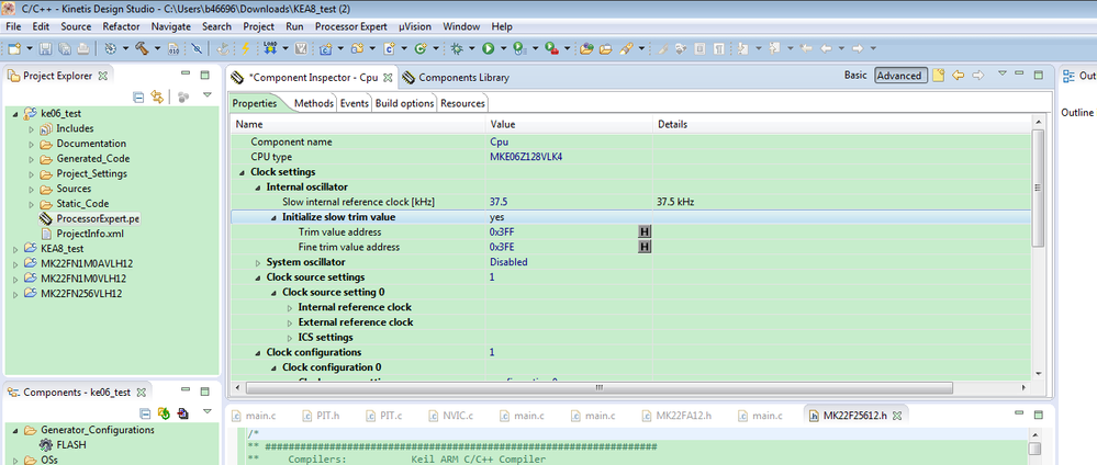

Thank you, we are using Processor Expert.  The checkbox to initialize the slow trim value is unchecked in both environments, although I found that checking the option to initialize the slow trim value makes no difference; Processor Expert still does not generate any code to initialize the slow trim value.  The option to program the trim value in the debugger options is unchecked, although checking that made no difference.  The debugger is somehow still programming 0x80 into the trim register, but only on one development computer.  I think we'll just have to work around it by writing our own code to read the trim value and program it.

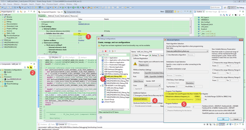

   I don't know whether you select the yes in the initialize slow trim value like my picture in the last reply:
Actually, after you select it, and generate the code, you will find there have the according code about it.
Then after you use the P&E tool, and configure the trim, the debugger will put the trim value in 0x3fe and 0x3ff, then when the code run to the above position.
It will copy the trim value to ICS_C3 and ICS_C4.

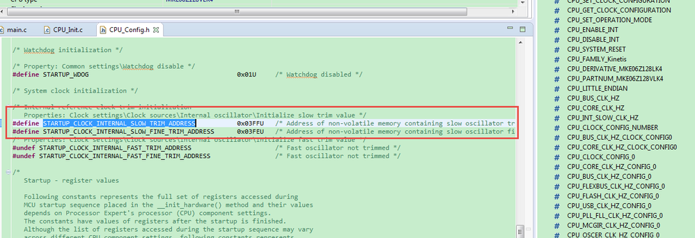

Thank you, but apparently enabling the ability to initialize the slow trim value does not cause STARTUP_CLOCK_INTERNAL_SLOW_TRIM_ADDRESS to be defined in the version I have, so it never reached the code in CPU_Init to read from 0x3fe and 0x3ff to set ICS_C3 and ICS_C4.  I saved the PE configuration, re-generated the processor expert code, but it did not work.  Where does the KE06 read the default values from at reset?  Apparently it is not 0x3fe and 0x3ff. I moved the line from CPU_Init to actually run and set the clock, but it set ICS_C3 and ICS_C4 to 0xFF.  My chip would power up with 0x58 and 0x0 for ICS_C3 and ICS_C4_SCFTRIM and run at the correct clock speed, but it had 0xFF stored in 0x3fe and 0x3ff.  I used the debugger option to re-calculate and store the values in those locations.  They are programmed there now, but I'm curious where the chip gets the factory default trim values from at reset.pastedImage_2.png
