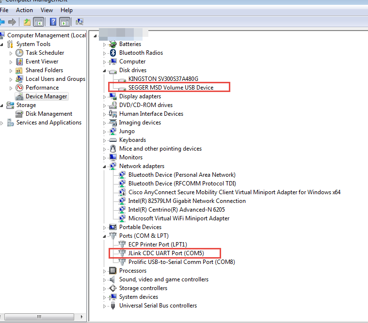

    1. Please check the debugger you are using at first.
      After you plug the SDA USB port on the board to your PC, then check the device manager:
      Computer->properties->Device Manager
This means, this FRDM-K22 is using the JLINK firmware.

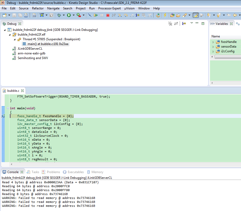

3. Use KDS open the bubble project:SDK_2.1_FRDM-K22F\boards\frdmk22f\demo_apps\bubble\kds
   If you are using the JLINK as debugger, please choose Run-> Debug Configurations->GDB SEGGER J-link Debugging
Just like this:
Then you will find your board enter the debugger mode:
Please following my step to try it again.

   Download to the flash, when you do the debugging, the code already download to the chip, you can exist the debug mode, and press the reset button on the board, then the bubble code will run.
   If you in debug mode, you must press the resume to run the code:

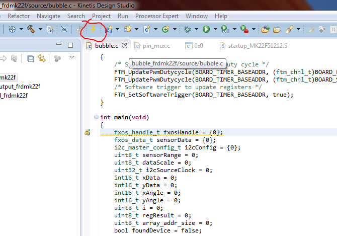

I have downloaded the code to the board through the lightning flash button...
But the does does not run not in debug or when I press the reset button.
I can step through the code in the debugger but it will not change the LED's.
