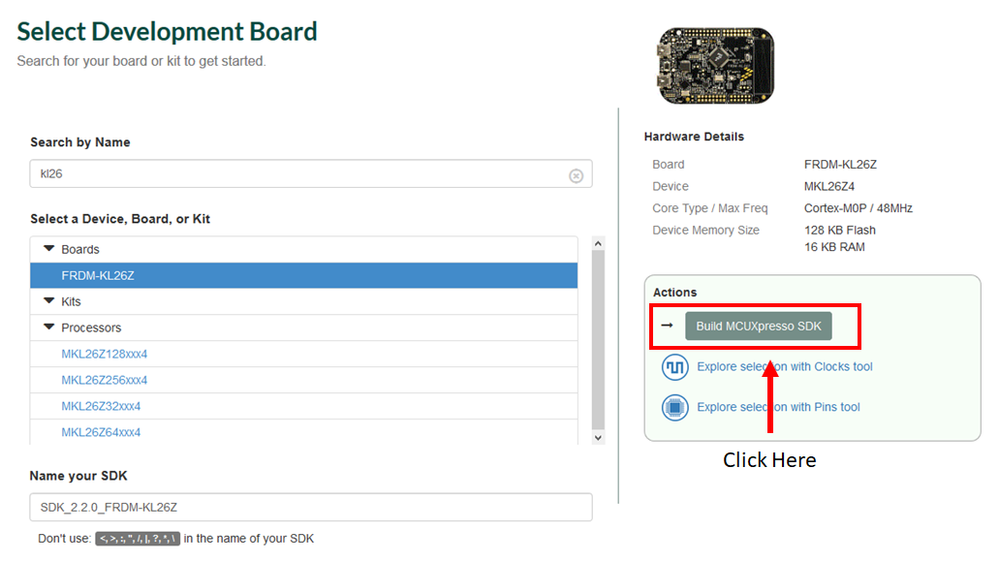

Unfortunately, you cannot use FreeRTOS on the KL26 with CW; this is due to the fact that this IDE is old and was never updated to work with what you are asking. However, I recommend you use the new IDE called "MCUXpresso" where you can use the SDK for the KL26 which has demo projects with FreeRTOS:
- MCUXpresso: https://www.nxp.com/support/developer-resources/software-development-tools/mcuxpresso-software-and-t...
- SDK Builder: https://mcuxpresso.nxp.com/en/select
Inside the SDK Builder Page, please select your board and make sure you include the FreeRTOS:
I hope this information can help you.
