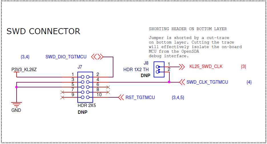

Hello everyone,
I am start working with ARM cortex M0+ micro controller. I am very new to it. So it would be very useful for me if anyone can share his/her knowledge with me. I am taking IAR Embedded workbench IDE for programming the controller. I initially wanted to know "what programmer should I take to burn the controller?" Like, I have searched and found 2 programmer mainly i.e. J-Link debugger cum programmer and PE micro universal debugger cum programmer. Both are highly costly for my project. Is there any cheap way through which I can burn the controller or I need to purchase one of the above debugger?
Sorry, If I am asking irrelevant question. Please correct me if I am not correct. & please provide me the options soon. :smileyhappy:
Hoping for any help :smileyhappy:
Priya

Hi priya,
You can buy a FRDM-KL26Z board.
The OpenSDA SWD CONNECTOR J7 on FRDM-KL26Z may meet your needs.
Please refer Freedom Board with Segger OpenSDA Debug Firmware.
