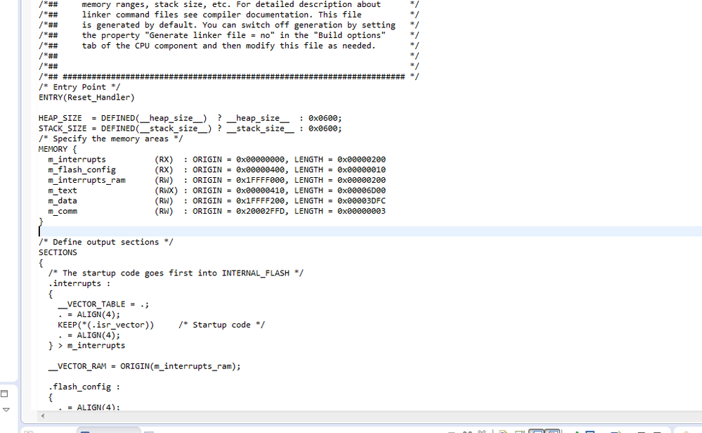

I'm having issues implementing a bootloader update.
Specs: CPU: MKL15Z128VFT4
OS: BareMetal
IDE: KDS 3.0.0
Drivers Used:
C90TFS Flash Driver
SPI Driver
Scenario:
I'm fetching 1kB at a time from SPI flash and writing 1KB (1 sector) to uC program flash.
My bootloader is from 0x0000_0000 to 0x6C00
My appcode is from 0x0000_7200 to 0x0001_FFFF
I know this isn't the best use of space, right now I'm just trying to debug the process to see if I can get consistent reads from SPI flash and writes to the uC program memory location.
In the code process here's sequence
move C90TFS function FlashCommandSequence to RAM
//each read/write is for 1kB
for(i = 0; i < numReads; i++)
1. read 1 kB from SPI flash
2. Enter Critical section - shut off Interrupts (ie OSA_EnterCritical(kCriticalDisableInt))
3. Disable OSA interrupt (ie SysTick->CTRL = mask & 0xFFFD)
4. erase 1kB sector on uC app area starting at 0x0000_6C01
5. verify erase section
6  program 1 kB sector
7. program check 1kB sector
8. Enable OSA interrupt
9. Exit critical section
I've moved the C90TFS function FlashCommandSequence to RAM to avoid access violations. When I run through the loop I'm always able to get through 2 iterations and the program craps out when I try to do a SPI read on the 3rd iteration.
1st iteration: write to 0x7200 of uC program flash
2nd iteration: write to 0x7600 of uC program flash
3rd iteration: 0x7A00 target address - the program fails at the location where I set the baud rate in the SPI_HAL_SetBaud method of the SPI peripheral. This is part of the SPI_DRV_MasterTransferBlocking method of the SPI peripheral. All values of the equation look correct, but the debugger console shows the message WARNING: T-bit of XPSR is 0 but should be 1. The initial error is Cannot read register 15 (R15) while CPU is running. Target halted PC = 0x0000_0000
Does any one have any thoughts I what is going on that would cause this to happen? Am I having a memory access issue here? I had thought that the FlashCommandSequence method doesn't return until the CCIF bit is cleared, so I can't imagine a uC program flash write is occurring that this time.

jonathan_guinta
Hey Jorge,
I placed the RelocateFunction in the loop that fetches 1kB from SPI flash and writes 1kB to internal program memory. This allows me to continually read from SPI flash at all addresses and write to the internal flash at a single address (overwriting the previous values fetched from spi flash at each iteration), but only at a single address internal program flash address. The addresses I've tried for the internal flash that work are 0x10000 and 0x11000. Address 0x12000 write failure manifests itself as:  I can write to it successfully, but when I try to read from spi flash again, the program crashes (hits DefaultIRQ). I've looked at the map file and nothing stood out to me as overlapping the addresses of the bootloader fw. Here's the linker file for the bootloader:
I must be doing something dumb, but I'm not sure what else to do at this point. I'm at a loss.
Just to reiterate specs:
chip MKL15Z128VFT4
I tried wrapping internal flash methods with Enter and Exit Critical. I had MCM_PLACR |= MCM_PLACR_ESFC_MASK. I copied FlashCommandSequence to RAM every iteration of the loop, not sure why this would be necessary, but appears to help. I'm using the LPTMR for the OS BareMetal.
Is there anything else I may be missing that you see?
Jon
I've attached the code for reference.

Jorge_Gonzalez
Hi Jonathan:
I cannot understand your algorithm well and you have some wrapper functions not shown (like m_flashController.readData) but at first sight I cannot see what is wrong.
However what called my attention is that both __ram_func[ ] and g_FlashLaunchCommand should be global and it seems in your code they are not. Try defining those as global.
Another thing that comes to my mind is compiler optimizations. If you have any optimizations enabled, try to disable them. Sometimes the compiler being "smart" causes headaches.
Regards!

jonathan_guinta
Hi Jorge,
So I was able to get to the bottom of it. In the structure provided by the C90TFS driver, the FLASH_SSD_CONFIG struct, the .PFlashBase should be at 0x00 and the .PFlashSize should be at 131072U (128kB). I had no idea these values were supposed to reflect the whole range of the program flash. I had thought they were provided for the programmer to specify within the program flash region where they wanted to program the application code, the subregion. I guess not, this appeared to be the source of the problem.
Jon
4,091 Views
Jorge_Gonzalez
Hello Jonathan:
I am glad to know you found the root cause. You are right, the configuration structure for the C90TFS driver is a description of the whole Flash memory, not only the used space.
I hope you are moving forward. In any further case please do not hesitate to ask.
Regards!
Jorge Gonzalez
