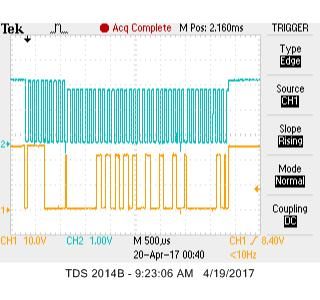

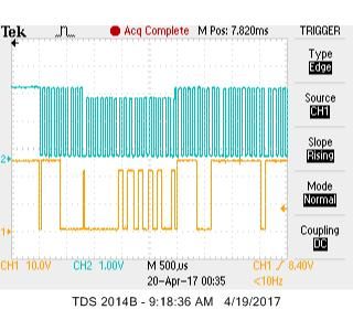

The following waveforms are a slave write (left) and slave read (right).  The slave address is 0b0000000001.

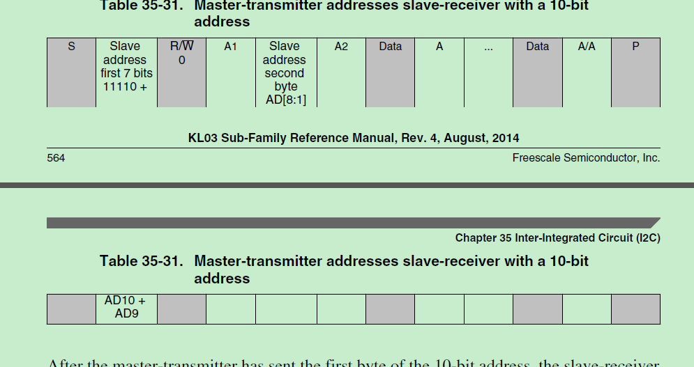

From reference manual:

Hi Johanna Gunter,
    Please check the KL03 reference manual, chapter 35.5.2 10-bit address at first, did you meet the 10bit address table? please also check your I2C bus data.
Please make sure you meet this table.
If you still have question, please let me know
