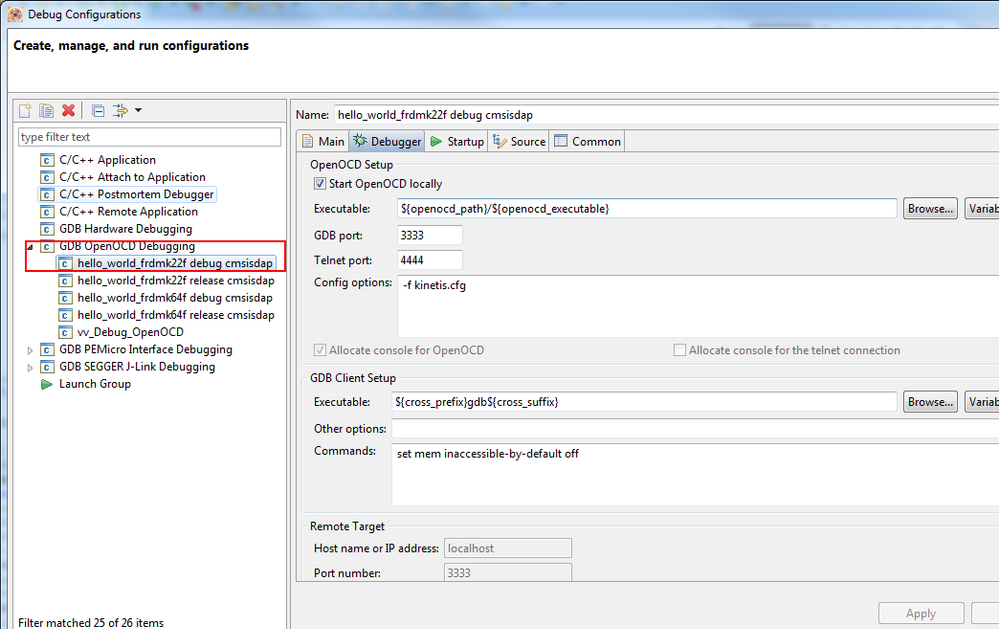

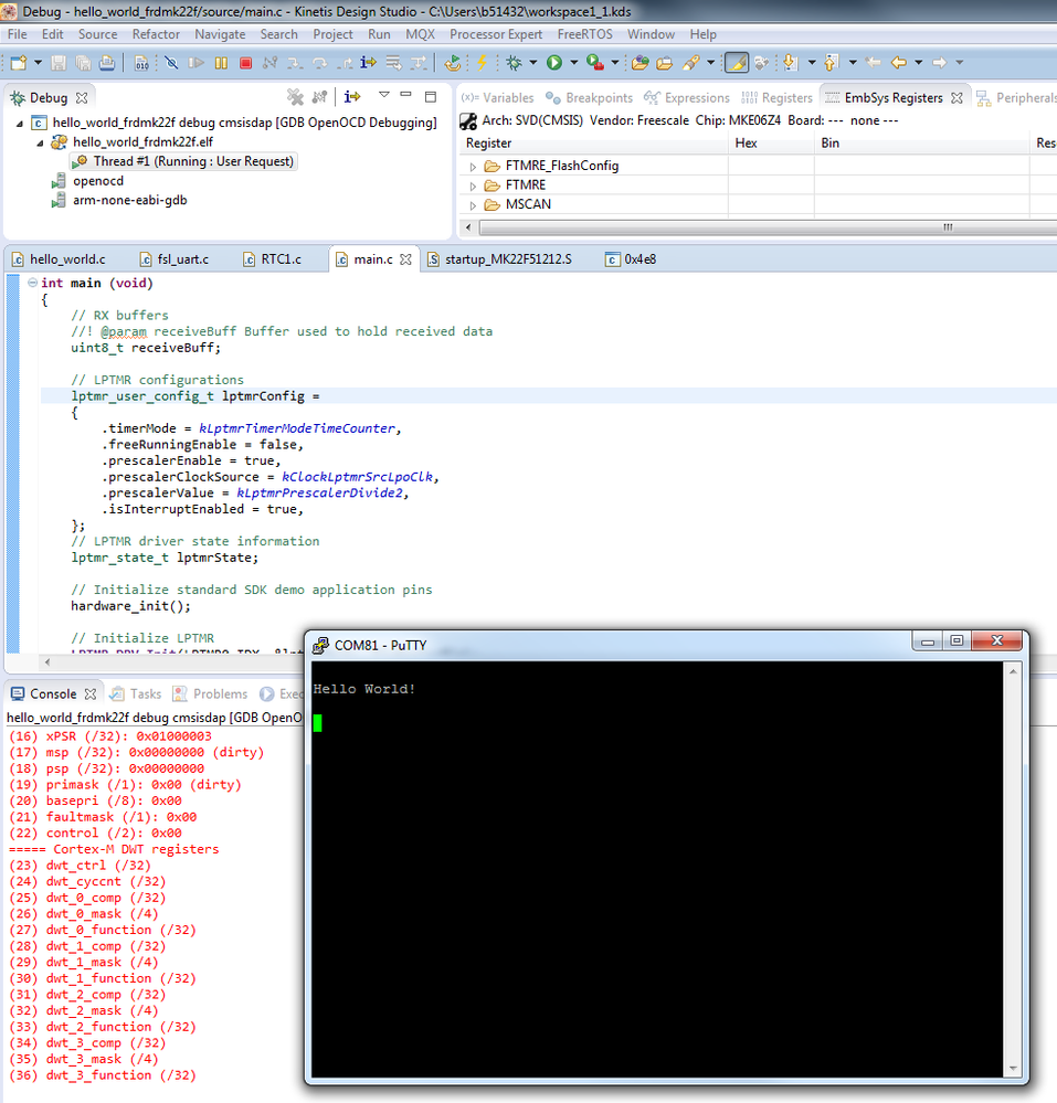

Hello Sheldon ,
Please update the OpenSDA bootloader use the firmware of "0221_k20dx128_k22f_0x8000.bin"(the attachment),
then when debug the demo configure the debugger like this :
I test it on my side, it can work well :
Please have a try , if it still can not work ,please take a screenshot about it step by step .
Alice

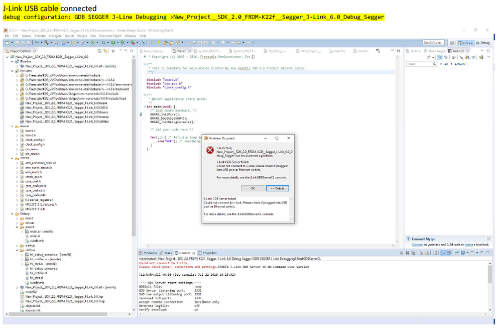

Now I'm having a new problem that may be because I'm not familiar with all of the Freescale tools. Without changing anything, I created a new project and I get the following error message:
          J-Link GDB Server failed:
          Could not connect to J-Link. Please check if plugged into USB port or Ethernet switch.
          For more details, see the JLinkGDBServerCL console.
Here's how I created and built the new project:
          Project Name: New_Project__SDK_2.0_FRDM-K22f__Segger_J-Link_6.0
          Select Kinetis SDK folder: C:\Freescale\SDK_2.0_FRDM-K22F
          Boards > New FRDM-K22F project
          Build
          Debug Configurations: GDB SEGGER J-Link Debugging > New_Project__SDK_2.0_FRDM-K22f__Segger_J-Link_6.0_Debug_Segger
Is a new, unmodified project missing something required to connect to the Segger J-Link debug Probe?

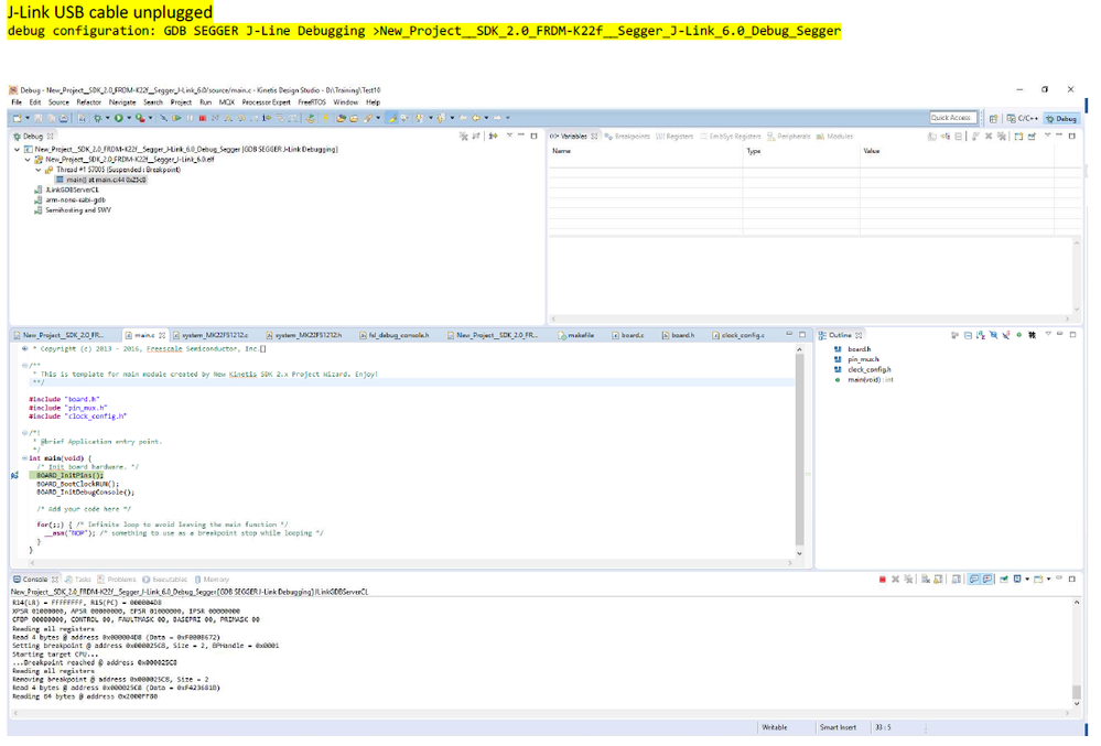

sheldonrubin
Hello Alice,
I just discovered that if I unplug the USB cable from the Segger J-Link I can apparently download the program to the K22f with no error messages and KDS enters debug mode. Here's the screenshot of the error message that results when I have the USB cable connected to the Segger J-Link:
Here's the screenshot with no error message for when I disconnect the USB cable:
Thank your for your help!
Sheldon
