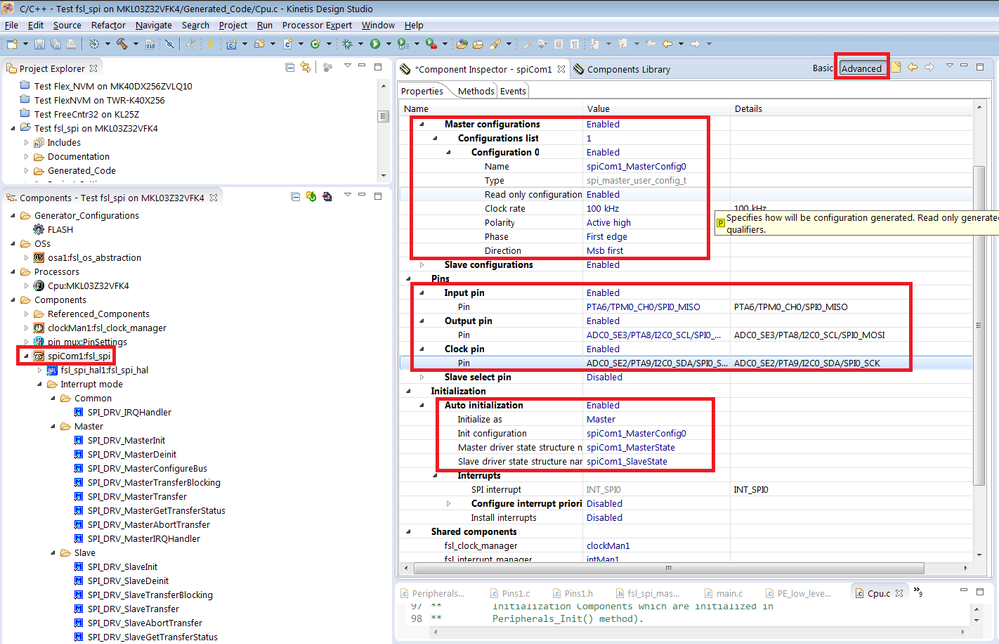

marek_neuzil
Hello Adam,

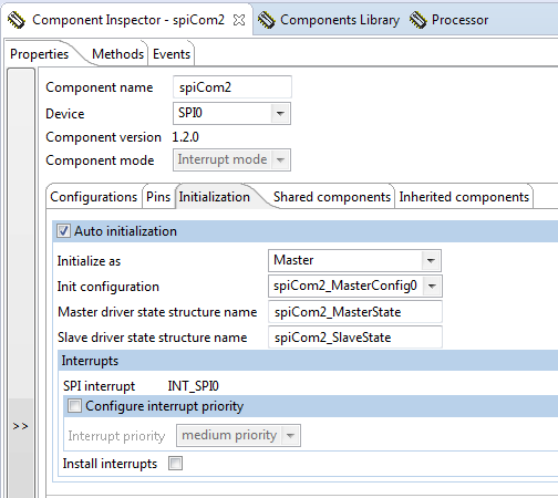

You are using Processor Expert and fsl_spi component. There is important to properly set the fsl_spi component and the initialization. You must properly set (enable) the
Master configuration, enable the Auto Initialization and set the Master configuration in the initialization (the Processor Expert generate spi device initialization code as a part of the PE_low_level_init() function - fsl_spi driver initialization functions are called in the ComponentsInit() function).
You must also enable and select used pins (these pins are disabled by default). See the screenshot below:

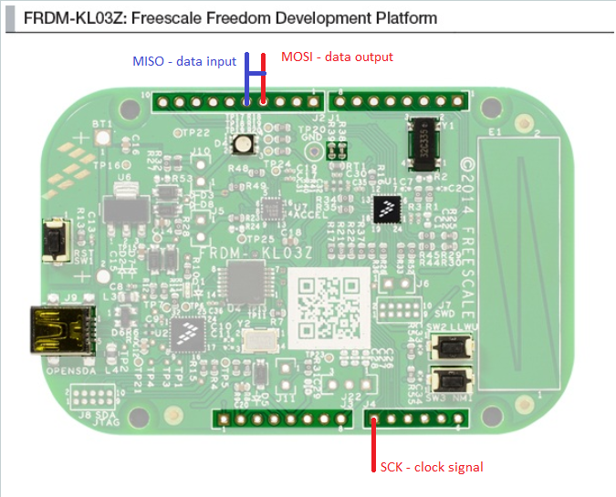

marek_neuzil
Adam,
I have checked the reference manual, FRDM-KL03Z scheme and everything is OK (PTA6 and PTA7 pins are not used by other devices). I have also created the target board application that work properly - SCK and MOSI signals are OK (data are sent). See the following picture of the board and used pins:
You can check the attached application that works on my FRDM-KL03Z target board properly.
When you connect PTA6 and PTA7 by a wire data are sent and received correctly in the application (see the connection on the picture above).

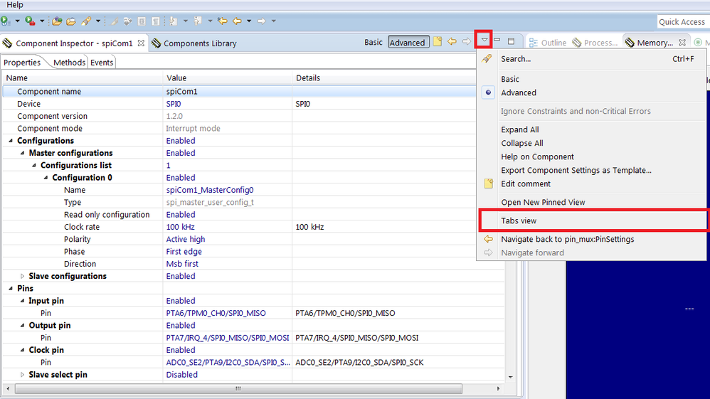

I am not using Tabs view in the Component Inspector window and therefore the view is different. If you want to use the same tree view navigate into Component Inspector window, open the menu and uncheck the Tabs view, see the screenshot below:
Marek Neuzil

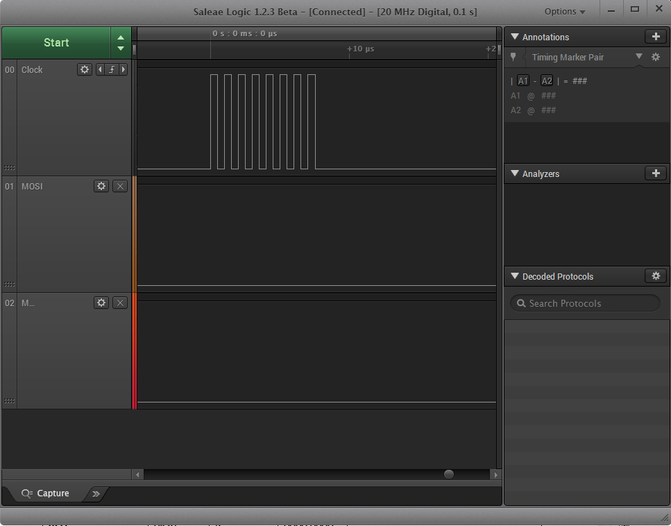

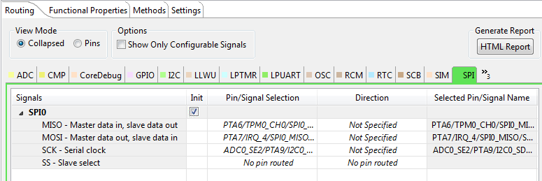

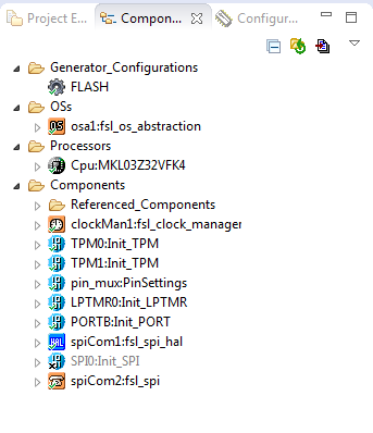

aeroengineer1
Marek,
I have confirmed that the pins were both configured as well as the SPI module was also initialized.  I have included a few screen grabs to show that this is the case.  I also am wondering why my configuration screen is different than what you showed in yours.  Even if I set it to advanced, I do not get the same configuration screen.  More of a curiosity than anything else.  I am running the stock KDS 3.0 with integrated Pex and KSDK 1.2.
Also note that I have included a screen capture of the my logic analyzer showing the clock doing what it should, but the data lines being silent.
Adam

aeroengineer1
Marek,
I believe that I have properly configured the pins as you suggested.  In the setup, there are only two options for pins that can be chosen, and in each one, I have made a selection.  Also note, the component is set to auto generate the initialization code (that is the setting, though it is greyed out and cannot be unselected).  Though I will be sure to double check tonight when I get back home.
out of curiosity, if that SPI module had not auto initialized, would one expect to see the clock line generating a signal when the SPI_DRV_MasterTransfer() is called?
Also one other piece of information, when debugging, I can see that the correct data is getting passed into the SPI_DRV_MasterTransfer() function, so the comment about initialization may be what I am missing.
