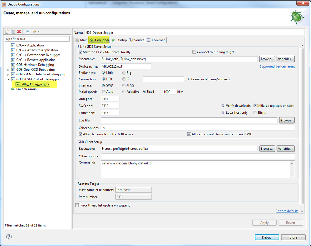

I'm new to KDS, I am trying to use it to develop firmware for a range of hardware I designed based on the FreeScale MKL05 and MKV10 ARM Cortex M0+ Kinetis chips. For testing and development I have a FRDM-MKL05Z Freedomboard. I'd like to use the FRDM-MKL05Z as a programmer for the target hardware (custom PCBs). I also have a segger J-link debugger probe tool
- Can I use the FRDM-MKL05Z as a debugger for custom PCBs ? If so how do I interface it with KDS all the tutorials only cover other Freedomboards.
- Can I use the Segger J-Link debugger, if so how do I setup the J-Link with Kinetis Design Studio

please refer below article for  how to Debug External Processors with USBDM and Freedom Board
Debug External Processors with USBDM and Freedom Board | MCU on Eclipse
if i work with MKL05Z16xxx4, i can use below debugger setting to connect board via J-link interface.
