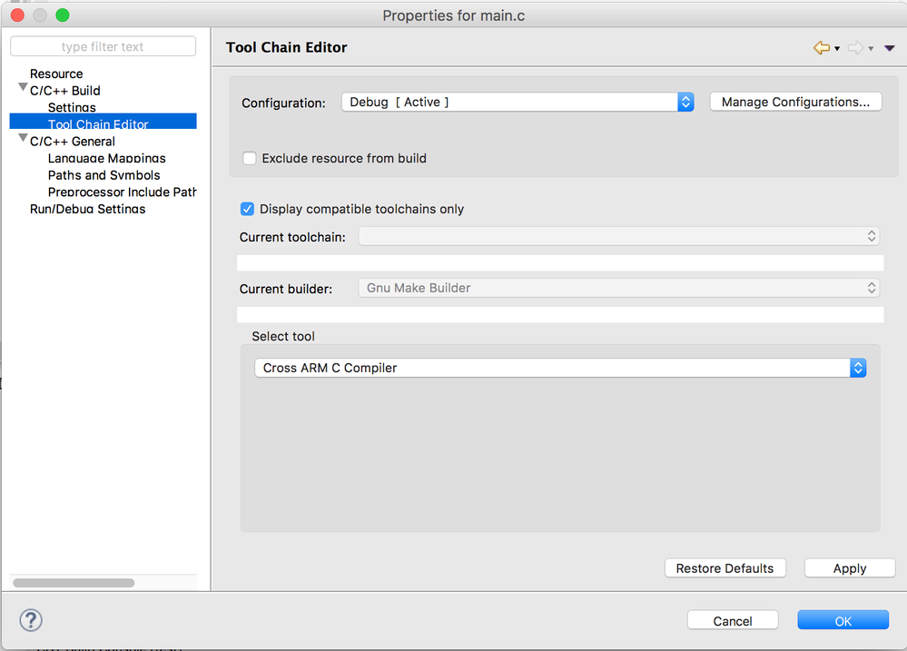

Nice video!  I have a newer version of KDS (ver. 3.2) - and I don't have a toolchain tab.   There's a toolchain editor - but I didn't know what do with it.
I'd like to generate an sreg file for the MSD Flash Programmer on my FRDM-KE04Z board.    I'm not clear if KDS can still do this on its own or if I need to install something.
8,421 Views
dstraight

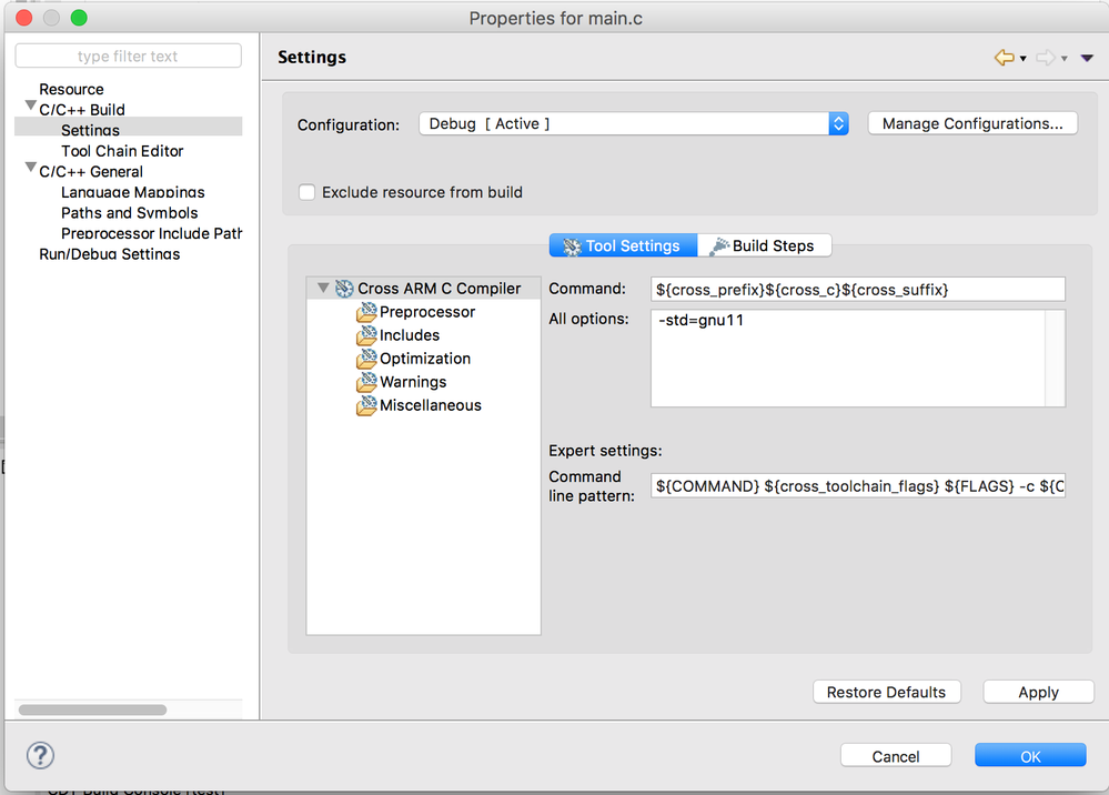

Okay, KDS 3.2 has a toolchain tab.  I mistakenly had a file highlighted instead of the project name in the project tree highlighted - so when I right clicked and selected properties I got the dialog shown above in the screen capture.  Anyway, once I highlighted the project name at the top of the tree I was able to access the toolchain and adjust the settings as shown in the video.  Thanks!
