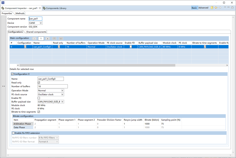

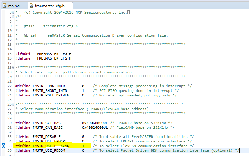

Jimny
Hello, iulianstan
Thank you for your reply.
The driver is already enabled and I have issues configuring it.
I use S32DS for ARM 2.2 and S32K144_SDK 3.0.0.
Let me describe the issue in detail.

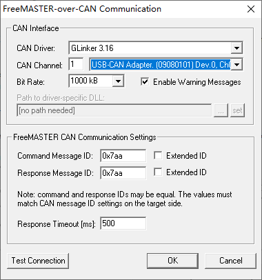

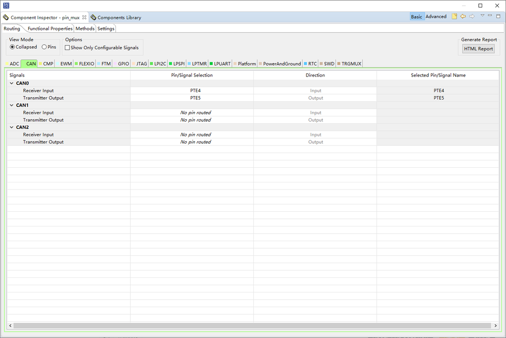

I have created a new project and configure the can_pal.
I have changed the configuration in freemaster_cfg.h to use the can bus.
In the main function, I initialized the clock and can peripherals. And the FMSTR_Init(), FMSTR_Poll() functions were also added.
Then I compiled the program and flashed it.

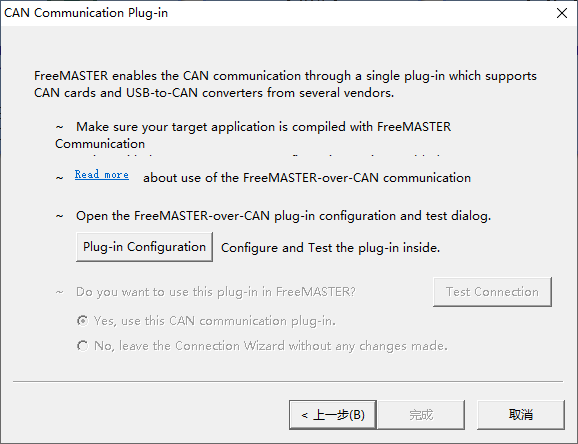

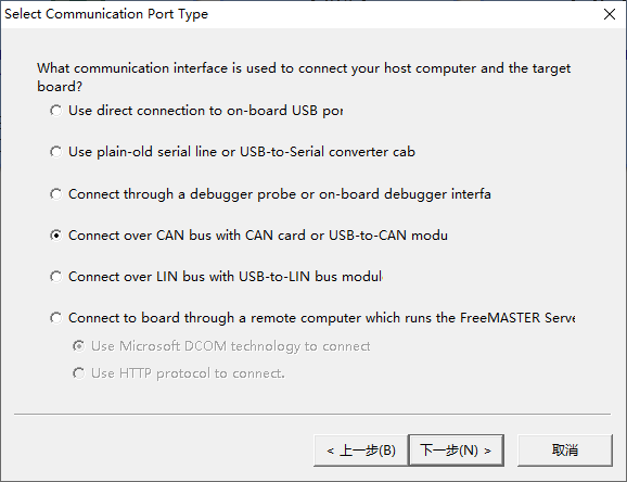

A freemaster project has been created to test the demo. I choose to connect the board over can bus.
Then I clicked the Plug-in Configuration.

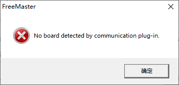

I use GY8507 interface card from GLINKER. It seems the driver is ok. When I clicked the Test Connection, an error occured.
I think I should have missed  some configuration in the code. Please see the project in the attachment.

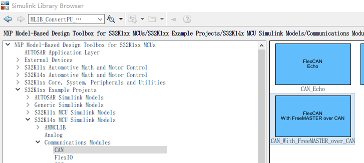

By the way, I have tested the model in the MBDT named "CAN_With_FreeMASTER_over_CAN", it works.

Hi @Jimny,
There are 2 things that need minor adjustments, one is in your code and another one related to the SDK:
  • In your code: you are using Short Interrupt Mode (#define FMSTR_SHORT_INTR 1) but you miss the piece that attaches FreeMASTER handler to CAN communication interrupt
    #if FMSTR_SHORT_INTR || FMSTR_LONG_INTR
        INT_SYS_InstallHandler(CAN0_ORed_0_15_MB_IRQn, FMSTR_Isr, NULL);
        INT_SYS_EnableIRQ(CAN0_ORed_0_15_MB_IRQn);
    #endif​
     If you don't want to use interrupts, you can switch to polling mode:
    #define FMSTR_LONG_INTR        0    /* Complete message processing in interrupt */
    #define FMSTR_SHORT_INTR       0    /* SCI FIFO-queuing done in interrupt */
    #define FMSTR_POLL_DRIVEN      1    /* No interrupt needed, polling only */​
  • The SDK: this reply explains the change. TLDR add this snippet after CAN initialization:
    /* Enter Freeze mode */
    CAN0->MCR |= (CAN_MCR_FRZ_MASK | CAN_MCR_HALT_MASK);
    CAN0->MCR &= ~CAN_MCR_MDIS_MASK;
    while((CAN0->MCR & CAN_MCR_FRZACK_MASK ) == 0){}
    /* Disable abort mechanism  MCR[AEN] = 0 */
    CAN0->MCR &= ~CAN_MCR_AEN_MASK;
    /* Enable the FlexCAN module */
    CAN0->MCR &= ~(CAN_MCR_FRZ_MASK | CAN_MCR_HALT_MASK);​
I also attached my main.c that should work in both modes. Let me know if it helps fixing your issue.
Iulian
10,697 Views
Jimny
Hi, @iulian_stan
Your solution works! Thank you very much.
