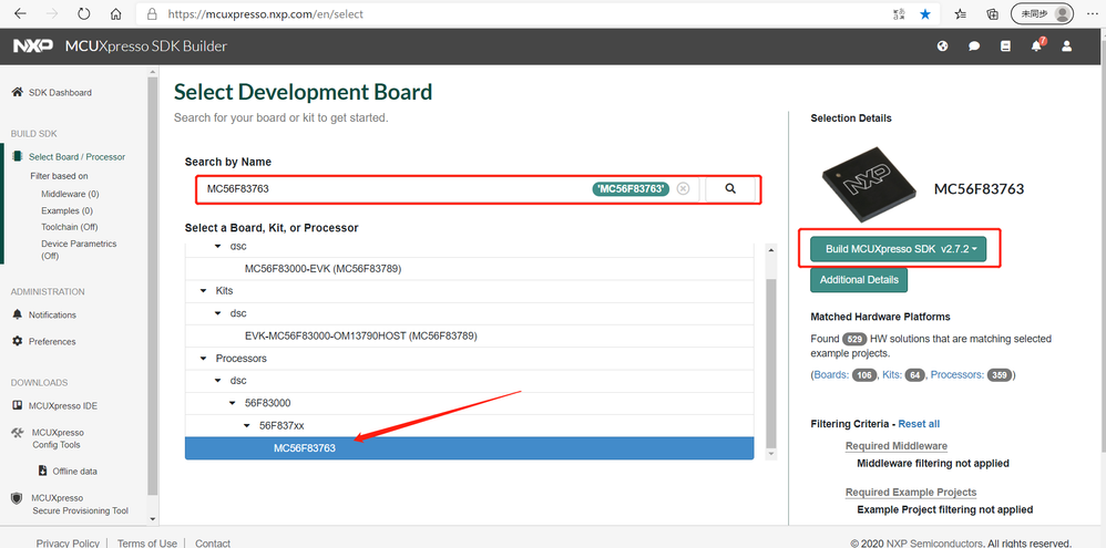

SDK name :  SDK_2.7.2_MC56F83763.zip (From MCUXpresso SDK Builder )

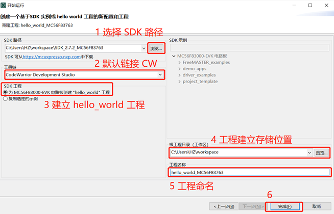

MCUXpress config build hello world project (new project) of MC56F83763 .
Questions:1. The hello world project has MC56F83778 CMD ?

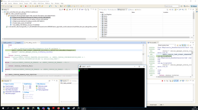

2. Debug failed as the picture:

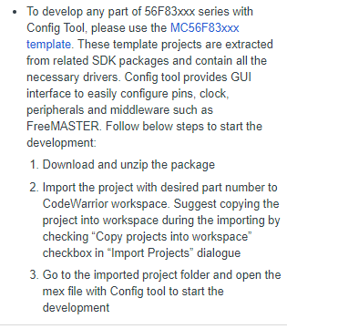

Hi, @547351265 , please go to www.nxp.com/dsc , navigate to 56F83xxx product page, expand "Enablement" , you'll see below words:
This is the correct way to create a new SDK based project for any 56F83xxx parts.

It appears that I can not download the SDK package from the SDK builder link:
Can you post the SDK package so that I can have a test?

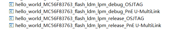

The private message has been sent to your hello world project .
It has no SDM_LPM, only LDM_LPM .
1.  MCUXpreeso SDK v2.7.2 from the picture
2. build hello world by MCUXpresso Config Tools from the picture:
