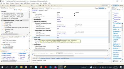

Dear NXP expert,
I found if i set the WAIT IN RAM --Yes. my program will run out of control if I declare an array[64], but is declare an array[32] is OK. and I set WAIT IN RAM --No. the program will run well. Can you give me some explain? my opinion is the stack overflow. And any suggestion about WAIT IN RAM item will be welcome.
Thanks.
3,179件の閲覧回数
xiangjun_rong
As the following figure and the "WAIT IN RAM" explanation, if you select "WAIT IN RAM" as Yes, it is in polling mode, in other words, the function polls the flash status register and checks if the flash operation is complete.
If you select "WAIT IN RAM" as No, it is in interrupt mode, in other words, after the flash operation is over, an flash interrupt is triggered, and the ISR will be executed, in the ISR, the flash status variable is updated. The advantage of the method is that you can execute the other function while the flash is operated.
Hope  it can help you
XiangJun Rong

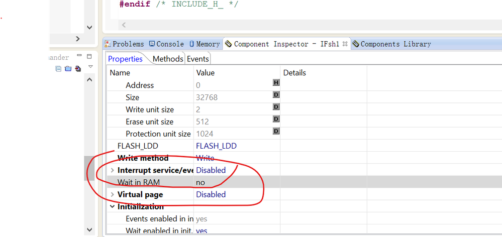

terrybogard
when I set the WAIT IN RAM --No, the data write into internal Flash is wrong.
