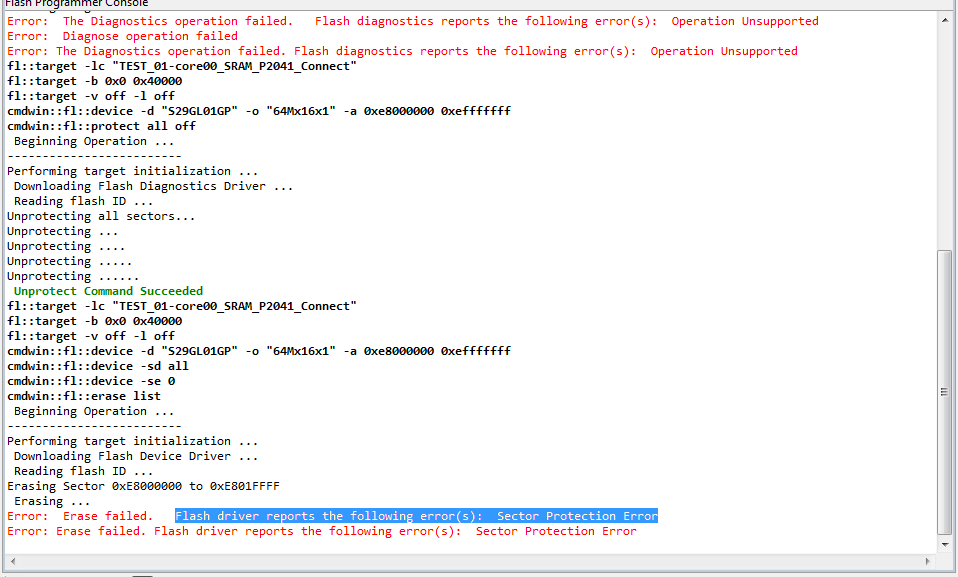

jagxin
dear sir
                I have used p2041 sram init .tcl file for initialitation and i was able to connect to the processor but when i am trying to erase the flash NOR flash the following errors are occurring how to solve this what are the possibilities all the schematics i have used the same as of evm except that i have used  this part of flash S29GL01GS10TFI010  instead of GP series
i have used the same init file  P2041RDB_init_sram.tcl provided from freescale do i have to change any setting in the init file i have used the S29GL01GP series for the flash device do the erasing algorithm mentioned in the .xml file is same for both flash series how to create a new flash .xml with eml file
