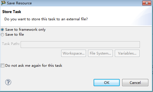

Hi All,
I am debugging a demo project and edit some configuration in Int_Flash.ttf. But when I close, it ask me to "Save to framework only" or "Save to file". I choose "Save to framework only". But after that, the ttf file disappeared from my project list.
My question is how could I find it and make it show in the project list?
Thank you.
-Daniel

Hi Daniel,
this dialog allows you to save the task to the Framework or in a file.
If the Framework only is selected, the task will be saved in the Task component only.
If you need a file you must select Save to File.
for details, please have a look to the Targeting Microcontrollers.pdf manual:
       19.3.11.3 Storing Task to File
