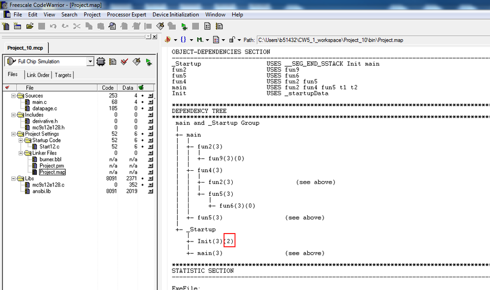

Hello
when enable the stack consumption , what is meaning  in the CW5.1, Init(3)(2)  the second " (2) "  meaning ?

2,084 Views
Fan_xy
Thank Pascal.
While i still not clearly.
I know that , for example  fun(3)(0)  , it is meaning the leaf function , that is the last function of one branch.
While  fun(3)(2) , the 2 meaning what ? (in my project , it is Init(3)(2)) .

TICS_Fiona
Sorry that I cannot address any document to describe the details for Dependency Tree. From your screenshot, it seems that the function Init() calls two subroutines, and these subroutines may be in assembly code or in libraries.
