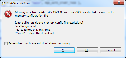

I am getting the following error which doing RUN in code warrior 10.6. I am using MK10DN128. How can I remove this error.

Hello Tahir
Could you please create a new bareboard project for MK10DN128?  Does CodeWarrior debugger work well with your board?
If not, please unsecure flash by mass ease as the attached doc.
In addition, CodeWarrior v10.6 is an old version, please upgrade to CW10.6.6.
Please first install CW10.6.4 which can be downloaded from:
CodeWarrior for Microcontrollers-Eclipse IDE|NXP
Its update v10.6.5 and v10.6.6 are also available at the same link.
