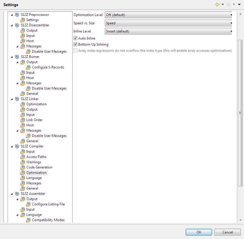

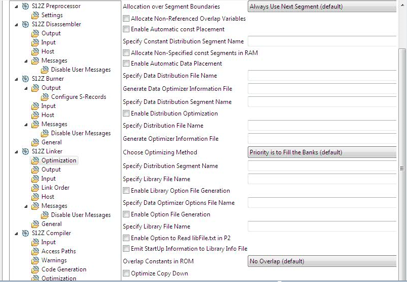

We are trying to implement unit testing for our code .For the unit testing tool to run it create stub functions of all the functions .These stub functions are not referenced in the code .It just needs to be linked in the object file created .
For previous version of codewarrior shown in the screenshot below there was option to keep or remove the unused sections.
Can you please tell how to do in present s12z linker setting  .As the linker is removing the unused objects in the object file created .
The present linker optimisation setting is this
Thanks in advance

Hello Pratibha,
Maybe you can try to add the unused function to ENTRIES section in prm file :
ENTRIES
     function_name
END
Please refer to :
How to include unused rtshc12.c.o (ansixbi.lib) and rtsxgate.cxgate.o (ansi_xgi.lib) functions into ...
and
"MCU_Build_Tools_Utilities.pdf"(under CW10.7 install folder:CW MCU v10.7\MCU\Help\PDF )  -> ENTRIES Block
Alice
