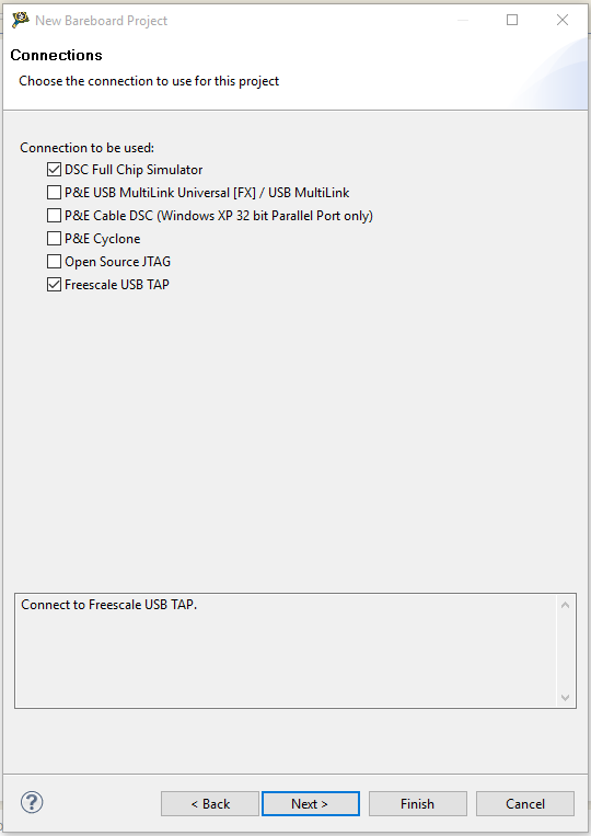

I would like to use CodeWarrior 10.7 on an 56F8135 MCU with an USB TAP (debugger)

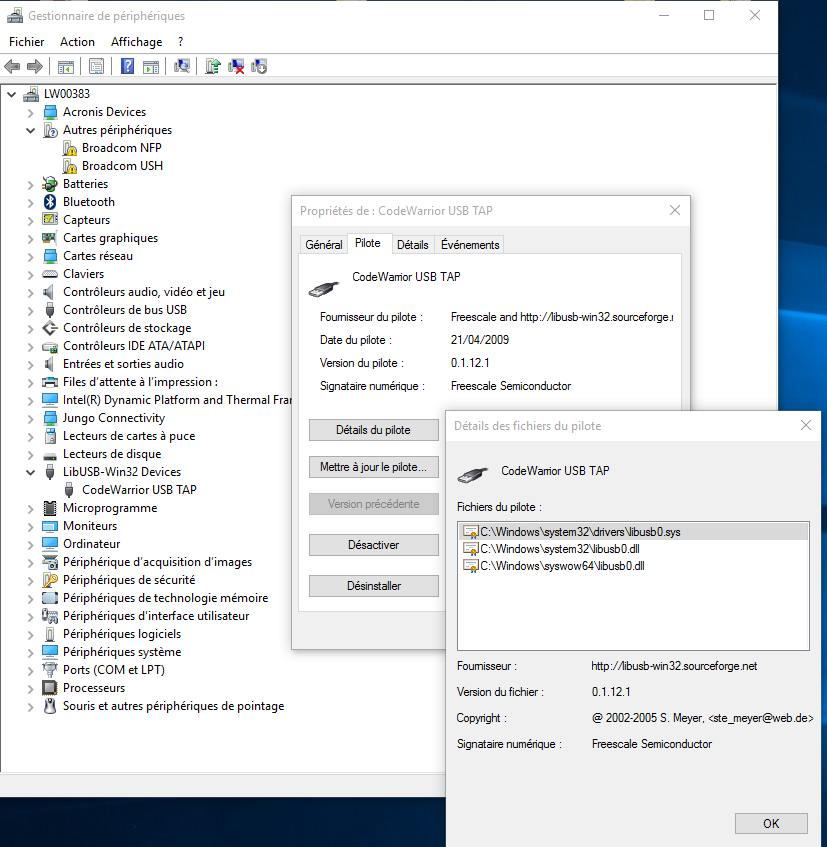

I have done setup.bat in "C:\Freescale\CW MCU v10.7\MCU\ccs\drivers\usb" and my device seems to be correctly detected :

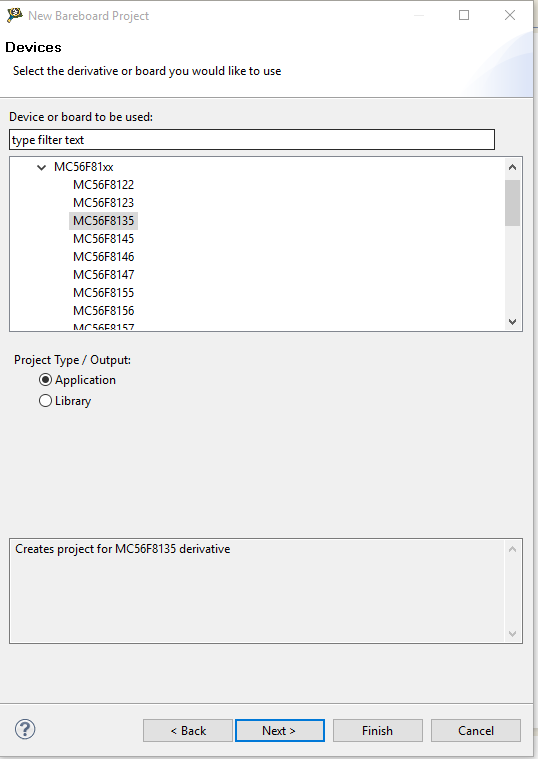

In CodeWarrior in create a "new workspace", "new MCU project", and select MC56F8135 :
For programmer I choose "Freescale USB TAP"
After the project creation, the compilation work well.

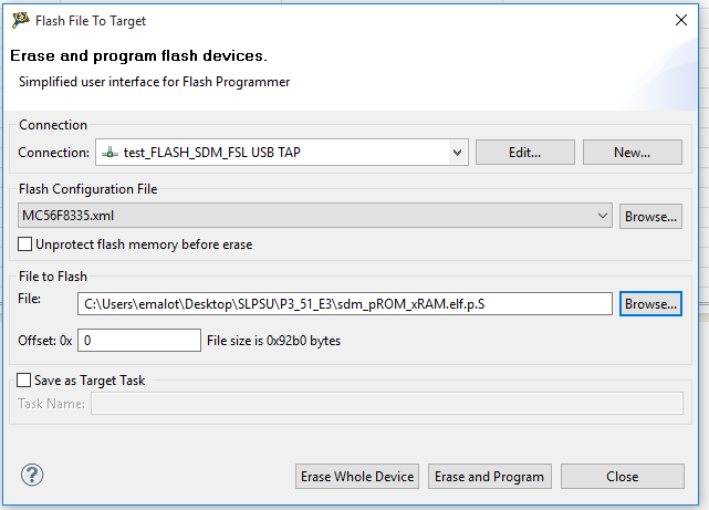

If I try to program the device with "Flash file to target" window :
 1) I need a "Flash configuration file" but the file "MC56F8135.xml" does'nt exist so I use the "MC56F8335.xml" instead :

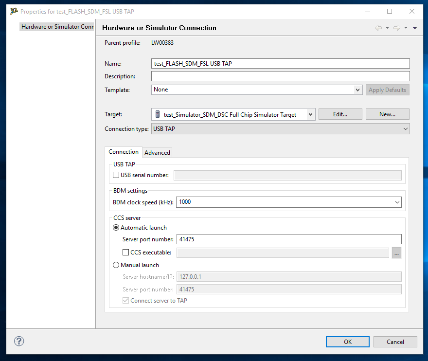

     (In Connection, Edit, options are as below)

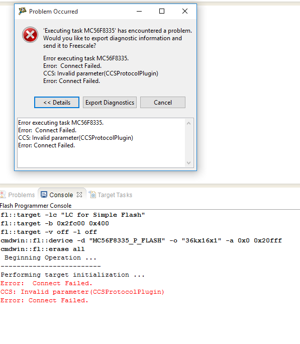

2) When I click to "Erase Whole Device" I get the error message below :
On the USB TAP, TX/RX led blink in green and Run/Pause led is OFF.
Does this issue is due to bad Flash configuration file" (MC56F8335.xml instead of MC56F8135.xml) ?
Does it possible to obtain/create  MC56F8135.xml ?

Ok, the USB TAP was out of order.
With a new USB TAP it works well.
