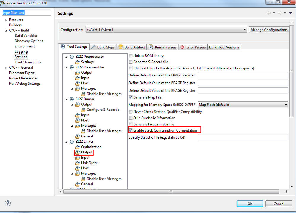

Hi Martin,
Which IDE and version do you use ?  CW10.6?
If yes, have you select here :
Hope it helps
Alice

martinleben
Thank you for your answer Alice, but I use 5.9.0 so your answer does not apply.
After all, this is the Classic/Legacy CodeWarrior area...! ;-)
Martin

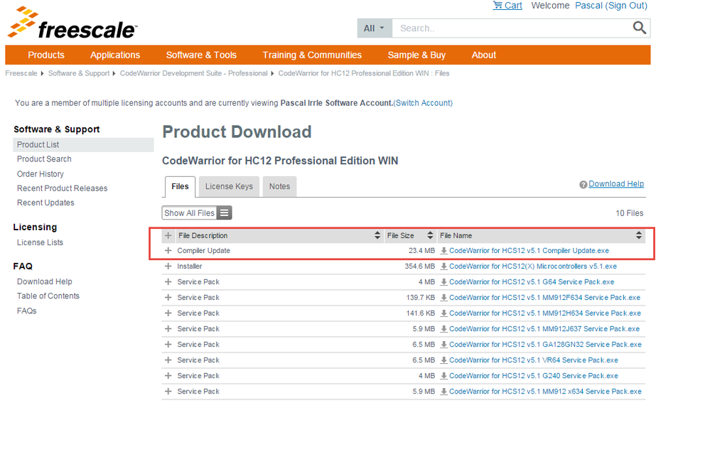

trytohelp
Hi Martin,
I'm working on a question regarding the -STACK_CONSUMPTION.
The HC12 v5.1 is supporting this feature too.
However you must install the compiler update.
This file can be downloaded through the web side under your Freescale account
Pascal
Freescale Technical Support
