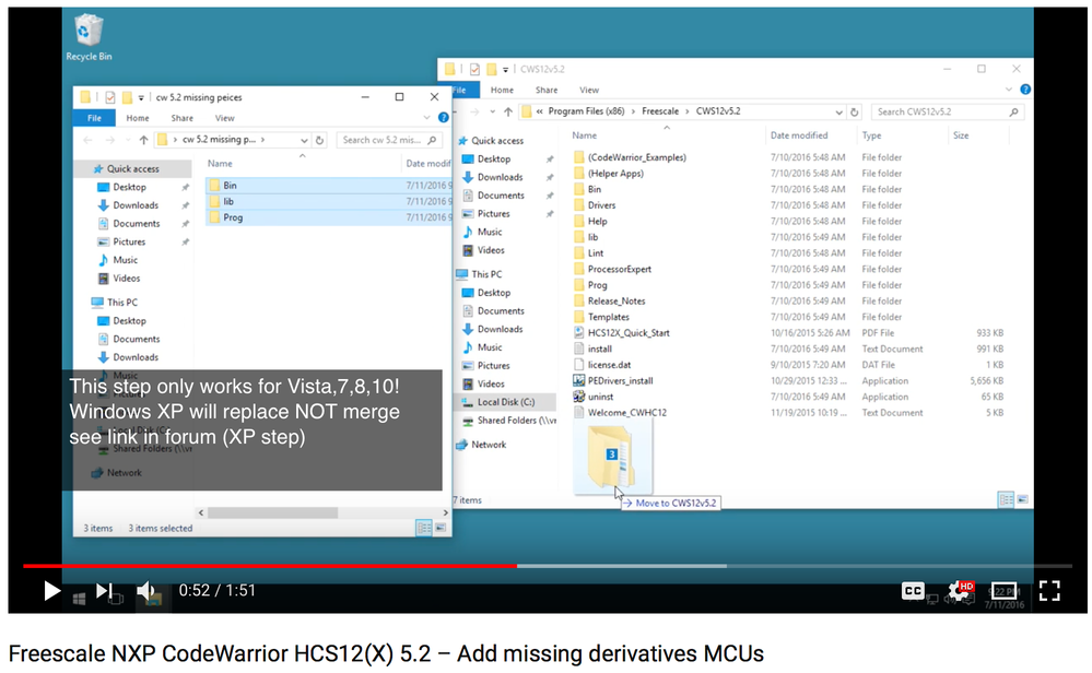

     Extract the attached zip (see bottom of post), so that you have three folders.
     Select and Drag the 3 folders (Bin,Lib,Prog) into the CWS12v5.2 folder probably in C:\Program Files...
         It will ask merge the files from the folders (overwriting some – answer yes)
     See the video to make sure you do this right (not for XP): Video Instructions (YouTube)

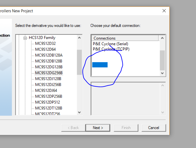

RodneyMcGee
The instructions are in the text of the main post.
Here is a picture that will help.
16,511 Views
yikunliu
it worked !!!!!
my mc9s12G64 appears in the list and Processor Expert useful
omg!!!!!
Forgive me for my bad English,
i don’t know how to express my thanks
it helps me a lot
Thank You!
