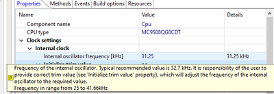

I am working with a MC9S08QG8 and Codewarrior V11 and I am using the SCI component (among others) so that I can have serial communication with the embedded hosting board from a custom software tried before.
When debugging, the communication works fine, but after I "Flash File to Target", thinking in production, the baudrate of the micro controller changes from 19230.769 to 21000 baud aproximattely.
I think that the timer is also afected, so I can deduce that the internal clock frequency is changing...
I have tried to program the micro controller with the .abs, .abs.args, .abs.s19 but with all of them the result is the same.
So, any idea of what can be goin on and how to fix it?
Thank you in advance.

If you use the internal oscillator, if you want accurate frequency, you have to use the trim register (ICSTRM see data-sheet chapter 10 ), and look at options to your programming tool, you probably found something about that.
Emmanuel

With your hint, I realized that the processor expert does not initialize the trim value registers.
It seems that when debugging, the values are inserted anyway, but not when flashing, so I introduce the needed values by "hand" and it works properly.
I wonder why the PE doesn't generate that code if it give you the option to select it...
Anyway, thank you again.

vicentegomez
mmmm weird
Please also set the trim value on the debug configuration options
Debug configuration/Edit/Advance debug.../ and then select the value that you need for the internal clock
