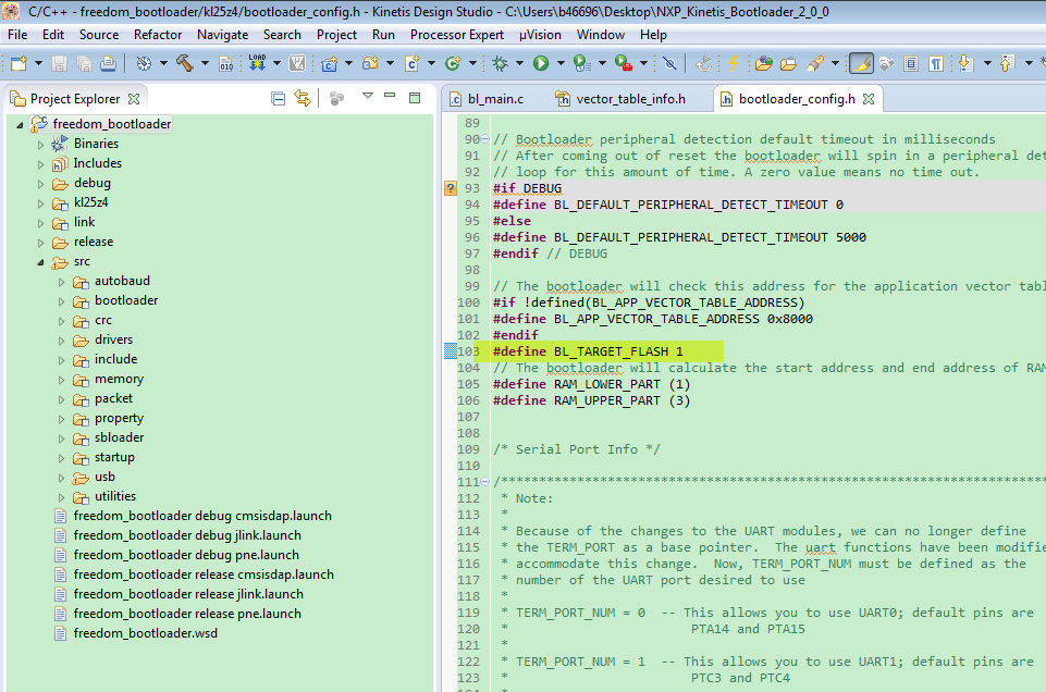

1.  open bootloader_config.h
   Add code :
#define BL_TARGET_FLASH 1
  I find the KDS IDE already add this define int he IDE options, but from the code, it seems not defined, you please add the code define like me.
After you add the code, and build the code, you can find the relocate address is BL_APP_VECTOR_TABLE_ADDRESS in vector_table_info.h.
This is very important, it will relocate the APP to address 0X8000, take care, not 0XA000, your 0XA000 is the K22 flash bootloader code.

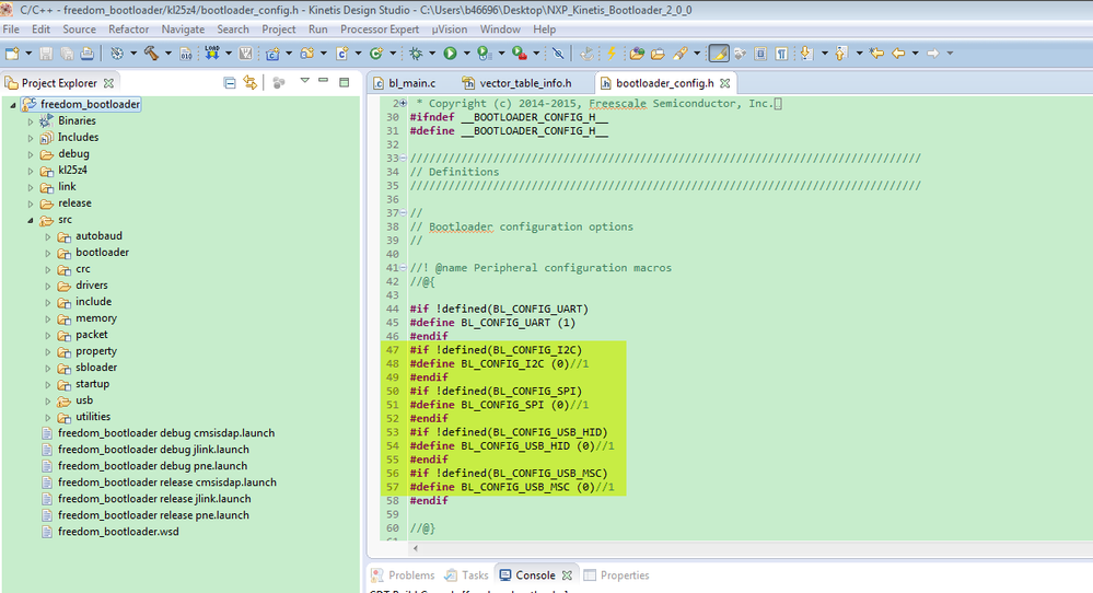

2.  Undefine the other peripheral: I2C, SPI, USB_HID, USB_MSC, just to minimize the code size.
   Still the bootloader_config.h:

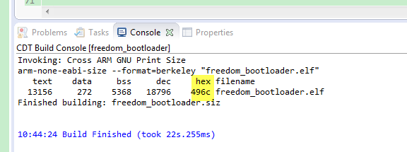

3. build the code in release mode, it will save the code size.
   Take care, the bootloader code size can't exceed 0X8000, because 0X8000 already the app address.
After build, you can find the code size in console:
0X496C is not exceed 0X8000, so it can be used.

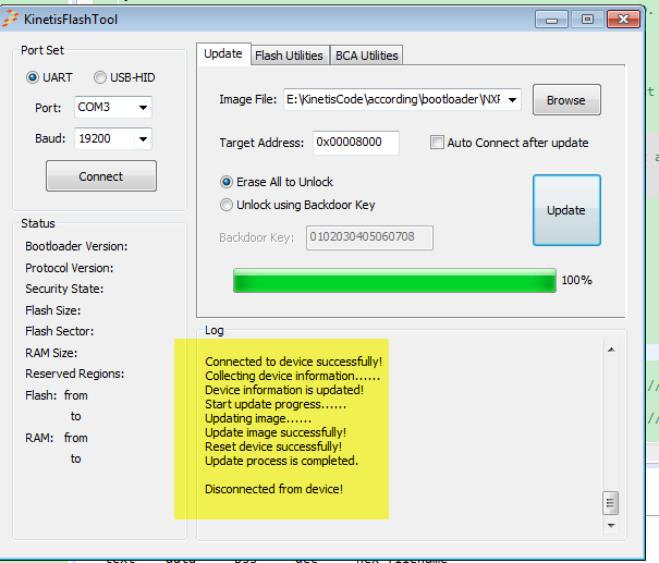

With the right bootloader, it connected successfully in Kinetis Flash Tool, and I followed your steps and set led_output demo ".ld" file to start from 0x8000:
Kinetis Flash Tool shows me it could update the application successfully:
I tried both your .bin and mine and the application doesn't start (the red led doesn't blink). Any idea?

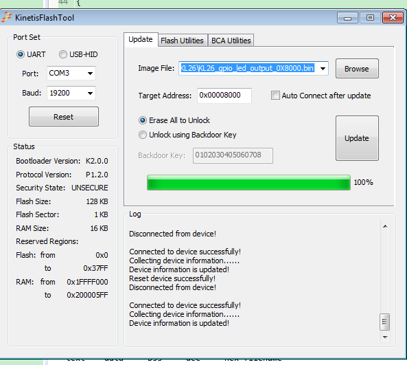

Dear Kerry Zhou,
I just noticed that in bootloader_config.h file, the baud rate is set to 19200 and the vector table address is set to 0xA000. So,  I supposed I have to change Target Address to 0xA000 and Baud to 19200 in Kinetis Flash Tool, but it keeps faling:
Marco Coelho
7,556 Views
kerryzhou
Hi Marco Aurelio P. Coelho,
     I find you are using the MK22F51212 bootoader from your attached picture:
   If you want to use the KL25 bootloader for the KL26, you must choose the KL25 flash bootloader in folder:
\NXP_Kinetis_Bootloader_2_0_0\targets\MKL25Z4\kds\freedom_bootloader
  I find you even can't connect to the UART COM port. Please use the correct target at first.
   I will give you the detail step and bootloader code which works ok on my side for the KDS project  in the next reply.
Kerry
7,556 Views
MAPC
Senior Contributor I
Hello, Dear Kerry Zhou
I have carefully followed your steps, but it doesn't work. The same connection failure comes up to me:
What should I do now?
Marco Coelho
