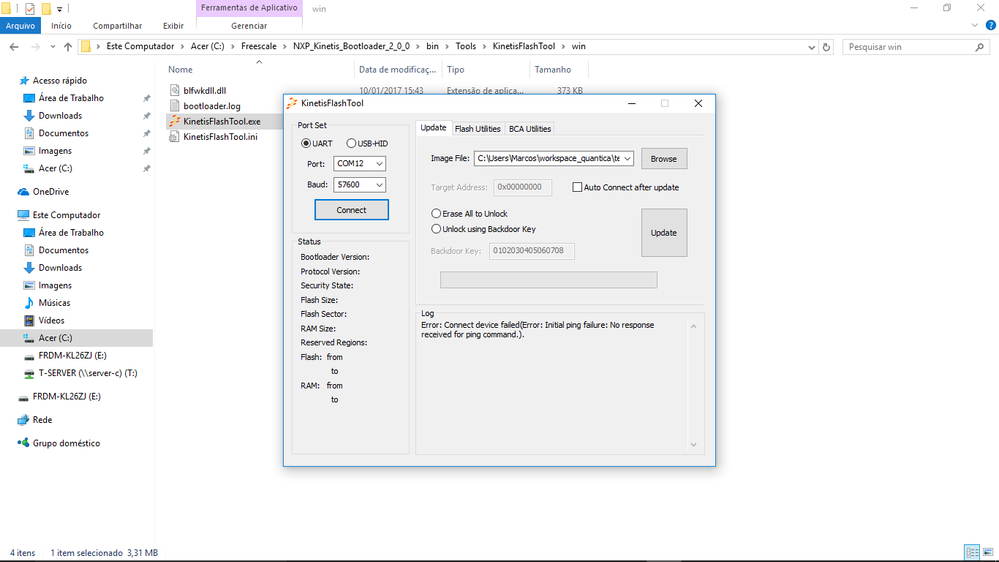

Hello!
I want to use KBOOT v. 2 to update my application in a MKL26Z128VLH4. As far as I saw, KBOOT v. 2 supports KL25, but it doesn't support KL26, although both have similar Flash memory map.
As I open Kinetis Flash Tool with my FRDM-KL26Z connected to PC USB port, Open SDA CDC COM Port is automatically recognized and baud rate is set to 57600, but if I click on Connect button, I get a message saying it can't connect to the board:
Theoretically, if it can recognize FRDM-KL25Z, it should recognize FRDM-KL26Z, that has a MCU with similar Flash memory map. Shoudn't it?
How can we fix this?
Thanks!

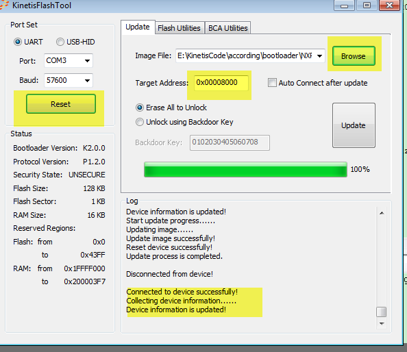

     KBOOT2.0 KL25 flash bootloader also support the FRDM-KL26 board, I already checked it on my side, it works ok.
    Now, please follow my step and try again.

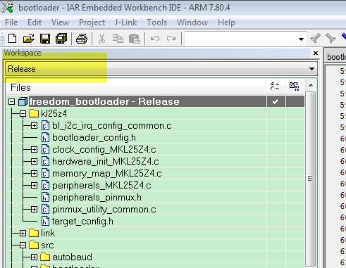

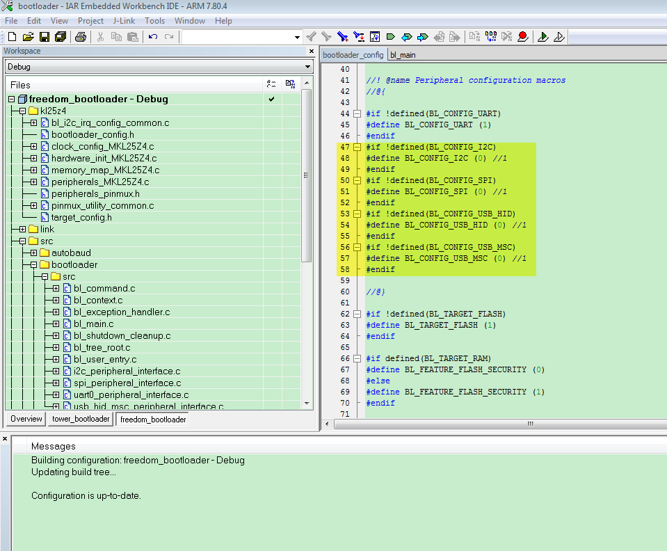

1. open KL25 flash bootloader from folder: \NXP_Kinetis_Bootloader_2_0_0\targets\MKL25Z4
   Please modify the bootloader_config.h, close the I2C, SPI, USB bootloader, like this:
   Change the debug to release
Then build the freedom_bootloader, and download it to the FRDM-KL26 board.

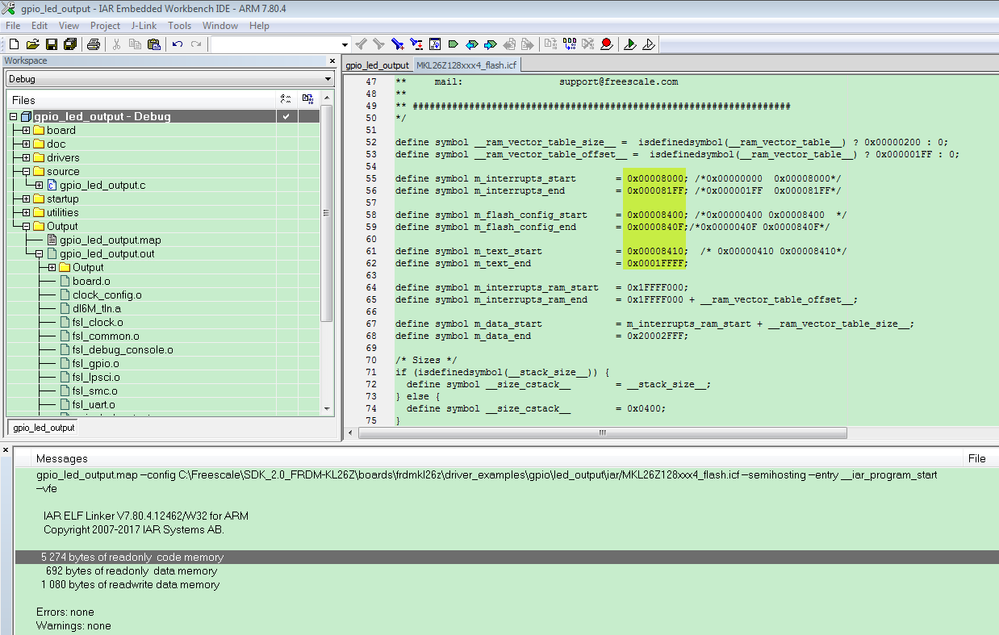

2. prepare the app.bin code, you need to relocate the app to 0X8000.
  Take SDK_2.0_FRDM-KL26Z\boards\frdmkl26z\driver_examples\gpio\led_output as an example.
  You need to relocate the code to 0X8000 like this, modify the .icf file:
Then generate the .bin file and build it.
 I also attached the app bin file:KL26_gpio_led_output_0X8000.bin
3. Open KinetisFlashTool
   1) browse, select KL26_gpio_led_output_0X8000.bin
   2) Target Address:0X8000

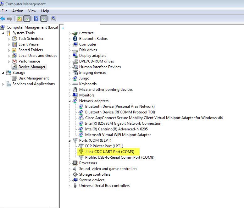

   3) Press the FRDM-KL26 on board Reset button, at the same time click the Connect button on KinetisFlashTool.
   You will find it can be connected. Please make sure the port COM number is your board's COM number, you can check it from the device manager
   4) Click Update button
Until the update process is completed. Then you will find the on board RED LED is blinking.
Please follow my step and try again on your side.

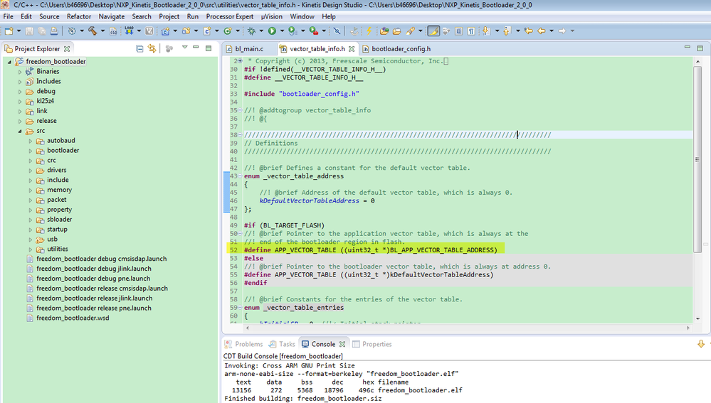

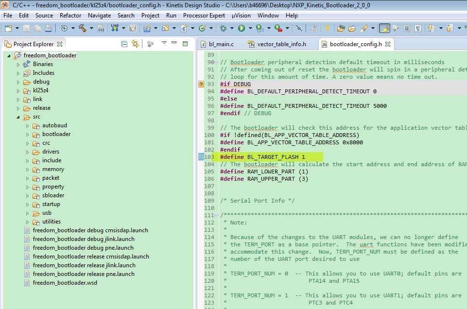

   I have tried the KL25 KDS project on my side, and it works ok with FRDM-KL26, I have attached the KDS KBOOT2.0 flash bootloader project for your reference.
   Please follow my following step try it on your side again:
1.  open bootloader_config.h
   Add code :
#define BL_TARGET_FLASH 1
  I find the KDS IDE already add this define int he IDE options, but from the code, it seems not defined, you please add the code define like me.
After you add the code, and build the code, you can find the relocate address is BL_APP_VECTOR_TABLE_ADDRESS in vector_table_info.h.
This is very important, it will relocate the APP to address 0X8000, take care, not 0XA000, your 0XA000 is the K22 flash bootloader code.

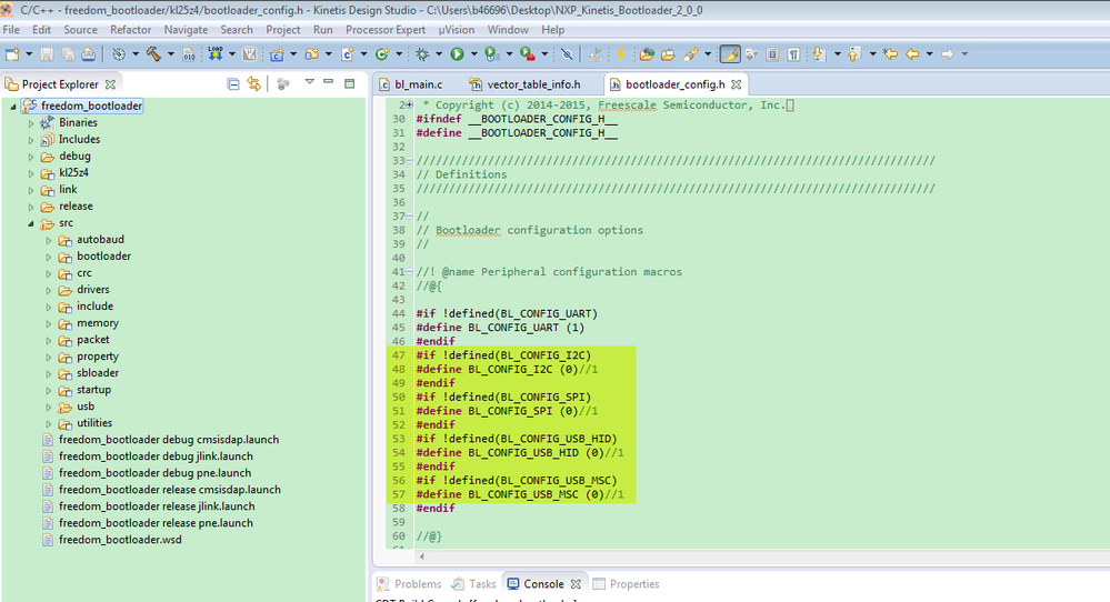

2.  Undefine the other peripheral: I2C, SPI, USB_HID, USB_MSC, just to minimize the code size.
   Still the bootloader_config.h:

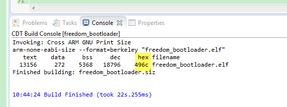

3. build the code in release mode, it will save the code size.
   Take care, the bootloader code size can't exceed 0X8000, because 0X8000 already the app address.
After build, you can find the code size in console:
0X496C is not exceed 0X8000, so it can be used.

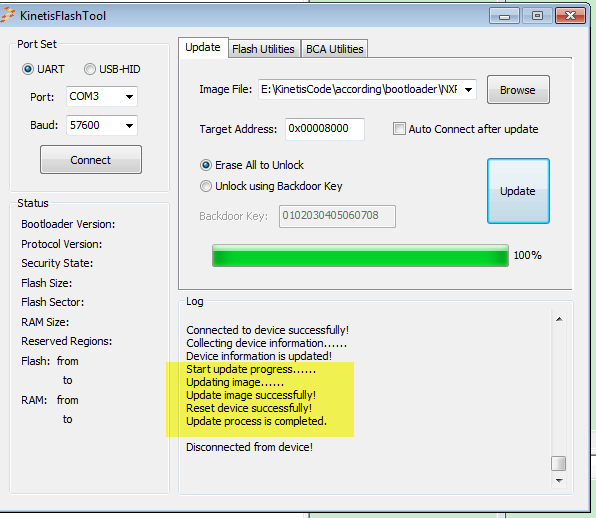

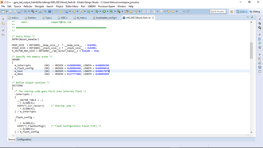

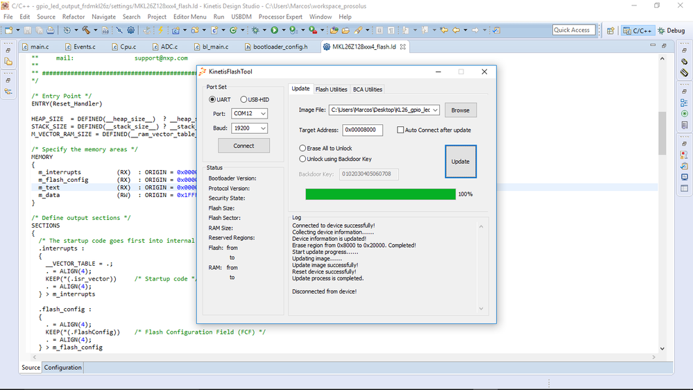

I really loaded the wrong bootloader code. Thanks for warning me! Pure distraction!
With the right bootloader, it connected successfully in Kinetis Flash Tool, and I followed your steps and set led_output demo ".ld" file to start from 0x8000:
Kinetis Flash Tool shows me it could update the application successfully:
I tried both your .bin and mine and the application doesn't start (the red led doesn't blink). Any idea?

kerryzhou
Hello Marco Coelho,
    It's good to hear you can connect and download.
    Now two more point you need to take care:
  1. Board is FRDM-KL26, don't use FRDM-KL25 with my .bin, because the GPIO port is not the same.
  2. Keep patient, as you know, the flash bootloader have the timeout time, when you reset the board, the code enter the bootloader at first, after about 5 seconds, the bootloader code will timeout, then it will enter the application code. So, after reset the board, wait about 5 seconds, you will see the RED LED is blinking in the FRDM-KL26 board. If you still not OK, try to connect and update the application code again, make sure you are using the correct .bin file.
Wish it helps you!

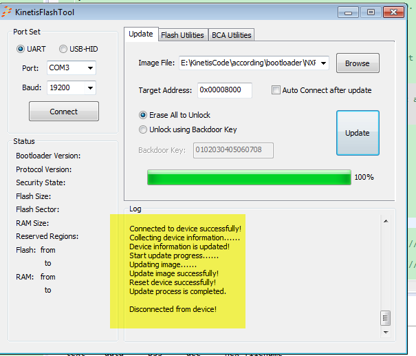

I just noticed that in bootloader_config.h file, the baud rate is set to 19200 and the vector table address is set to 0xA000. So,  I supposed I have to change Target Address to 0xA000 and Baud to 19200 in Kinetis Flash Tool, but it keeps faling:
Marco Coelho
4,742件の閲覧回数
kerryzhou
Hi Marco Aurelio P. Coelho,
     I find you are using the MK22F51212 bootoader from your attached picture:
   If you want to use the KL25 bootloader for the KL26, you must choose the KL25 flash bootloader in folder:
\NXP_Kinetis_Bootloader_2_0_0\targets\MKL25Z4\kds\freedom_bootloader
  I find you even can't connect to the UART COM port. Please use the correct target at first.
   I will give you the detail step and bootloader code which works ok on my side for the KDS project  in the next reply.

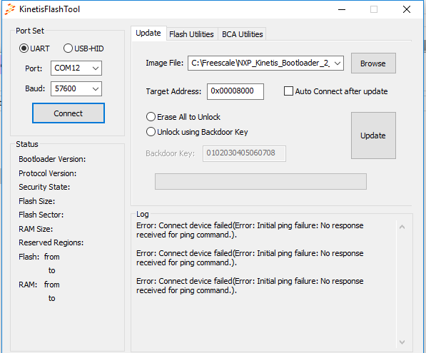

MAPC
Senior Contributor I
Hello, Dear Kerry Zhou
I have carefully followed your steps, but it doesn't work. The same connection failure comes up to me:
What should I do now?
