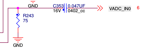

I am trying to use the VADC at the MX6SX SDB. (i.MX L3.14.52_1.1.0 GA)
I connected the camera input at the VADC_IN0, and I checked the signal after the C353 using the oscilloscope, and it is okay.
