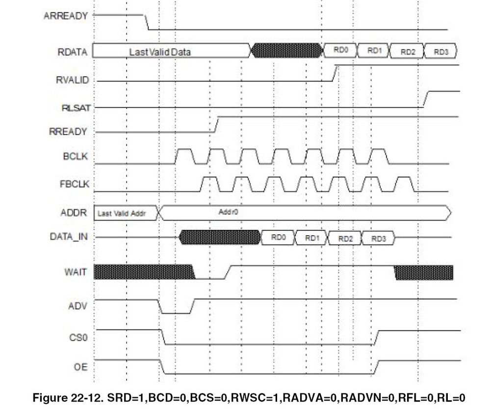

Now I ran into a different problem (or possibly two different problems).
The first chip select signal ECSPI1_SS0) seems to work although it works in a strange way. It goes low for every byte sent on the SPI bus. If I send 4 bytes it goes low and back high 4 times. I think it should go low and stay low for the entire transfer (all 4 bytes).
In the imx6 Reference Manual I found 21.4.4.1, Typical Master Mode. The diagram in that chapter is what I thought the SS signal should look like. Do I have to do something to set the controller in that mode?
The second chip select signal doesn't work at all. It doesn't go low when I send data to /dev/spidev0.1. The clock and the mosi lines wiggle as they're supposed to.
