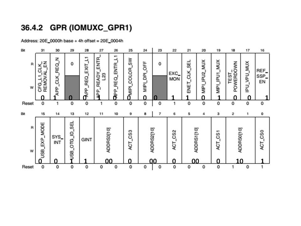

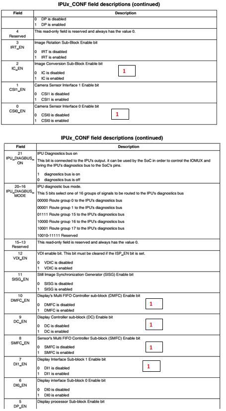

  3. The CSI0 connects parallel, IOMUXC_GPR1 = 0x48693005 and IPU_CONF = 0x00000785
I think this is due to the CSI/IPU not setup properly for BT.656 mode without hsync/vsync signals. Please give some support on how to configure the CSI/IPU with this camera?

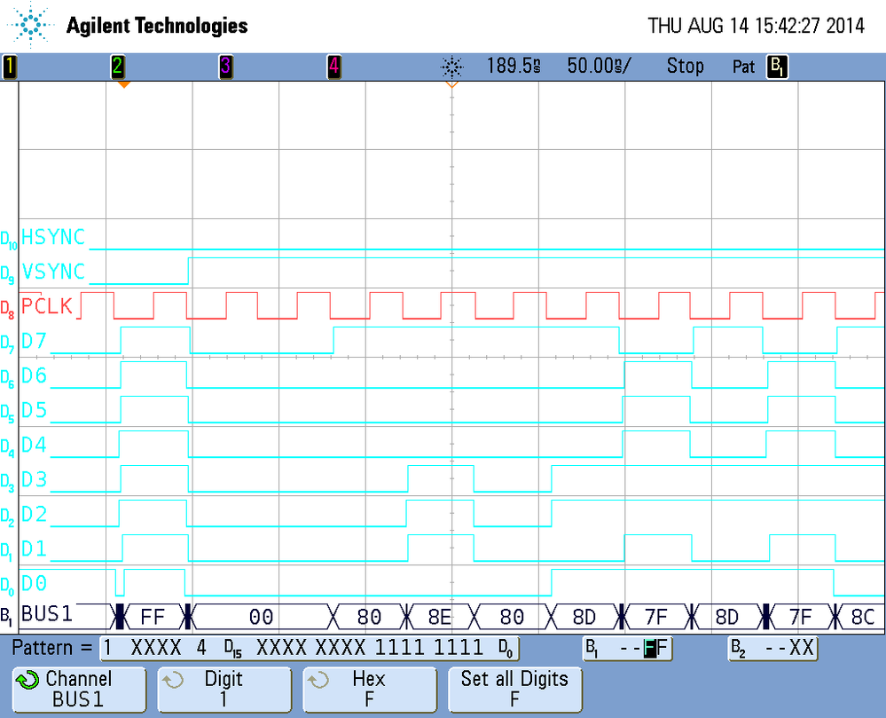

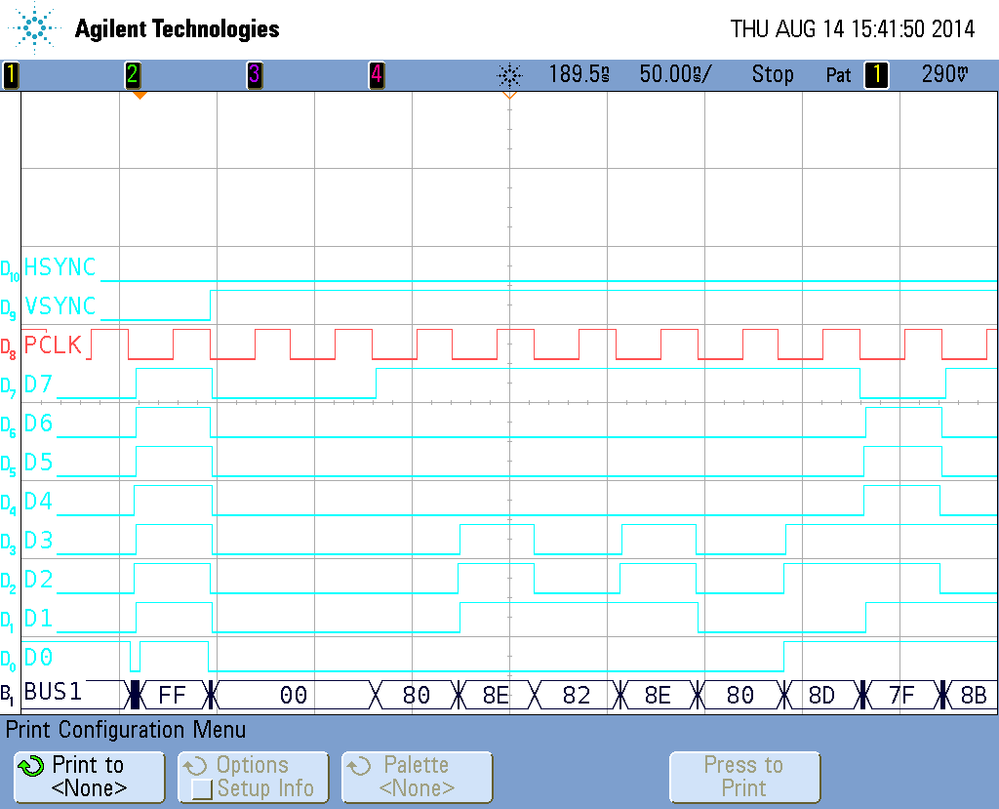

Hi Robert, if there is no EAV/SAV embedded on date line, the VSYNC and HSYNC pins are needed for BT656 input.
11,136 Views
robert_lim
Hi Qiang Li,
The EAV/SAV was embedded on data line, as shown below:
Robert
