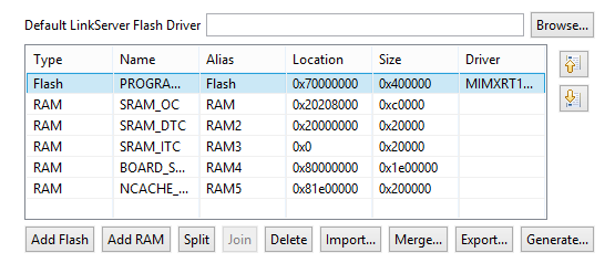

       Which place we have to change  0x20208000 address ?
Thanks & Regards,
       Vasu
2,606 Views
vasudhevan
Contributor V
      I have modified MCU settings but our code is not running.
 Vasu

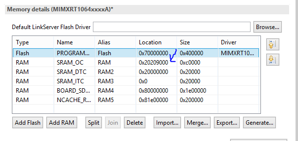

2,596 Views
jeremyzhou
Thanks for your reply.
After confirming, for the Non-XIP image, this should store into the area whose address starts the 0x20209000, just like the below shows.
TIC

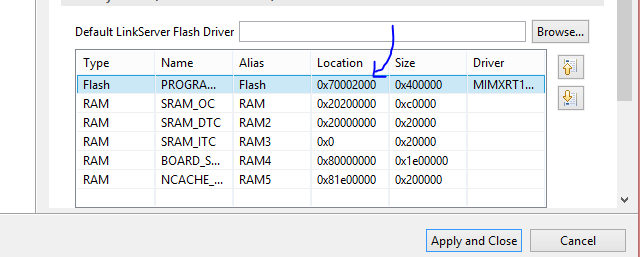

2,495 Views
jeremyzhou
After going through the steps, I don't find something wrong except for the application start address, it should be 0x70002000 instead of 0x70000000.
TIC
2,487 Views
vasudhevan
Contributor V
Hi @jeremyzhou,
     I have modified to 0x70002000.
elftosb.exe -f imx -V -c ..\..\bd_file\imx10xx\imx-flexspinor-normal-unsigned.bd -o evkmimxrt1064_lwip_tcpecho_freertos.bin evkmimxrt1064_lwip_tcpecho_freertos.srec
 After change not able to generate .bin file.
Thanks & Regards,
      Vasu

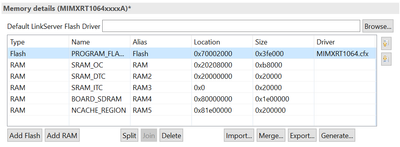

2,459 Views
jeremyzhou
Thanks for your reply and the SRAM_OC configuration is not right.
Please follow the below configuration.
TIC
